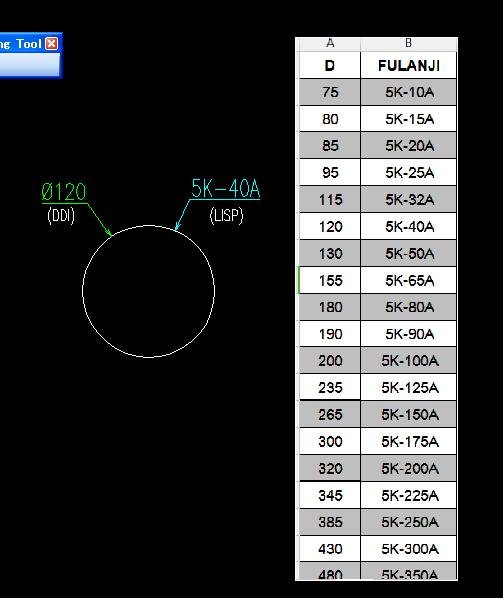

Help me!!!Convert dimensions according to other values
My job all day is to measure the diameter of a circle and then look at the board and assign it a parameter. Look up the table so hard, it's so boring, guys. Can anyone help me write a Lisp but instead of measuring the diameter and dimensions, always include the parameters in the table for me, please! I have attached the file. thank you very much I wish you health and happiness!
Furanji.dwg
Happy with this?
What to do:
- You draw the blue diameter dimension objects (they will display the diameter)
- command CDL (for Convert Dimensions Lookuptable)
- select a circle
- select a diameter dimension objects
-> the routine will read the radius of the circle, lookup the code in the table, if it finds it it will put that code as the text override of the dim
I put it in a while loop.  Press escape to exit
Check the data of the lookuptable and correct/extend if needed.

1st question to devitg why dotted pair ? (nth 1 (nth x)) & (nth 2 (nth x))
2nd question is to temy do the dims exist or do they need to be added to the circle ?
Thanks everyone!
With this lisp I have accepted it however I want it to be more complete for me. I want to keep the diameter size and it has a tolerance of + -0.5 and it has its own layer!!!

Please upload a  sample dwg . with  a before and after

Assuming that the diametric dimensions already exist in the drawing, you could reduce the program to a single prompt for a selection of multiple dimensions, extracting the diameter from the dimension measurement:

    (if
        (setq s
            (ssget "_:L"
                    (0 . "*DIMENSION")
                    (-4 . "<OR")
                        (070 . 003)
                        (070 . 035)
                        (070 . 067)
                        (070 . 099)
                        (070 . 131)
                        (070 . 163)
                        (070 . 195)
                        (070 . 227)
                    (-4 . "OR>")
        (repeat (setq i (sslength s))
            (if (setq i (1- i)
                      x (entget (ssname s i))
                      m (cdr (assoc 42 x))
                      v (vl-some '(lambda ( x ) (if (equal m (car x) 0.5) (cdr x))) l)
                (entmod (subst (cons 1 v) (assoc 1 x) x))
Edited by Lee Mac
