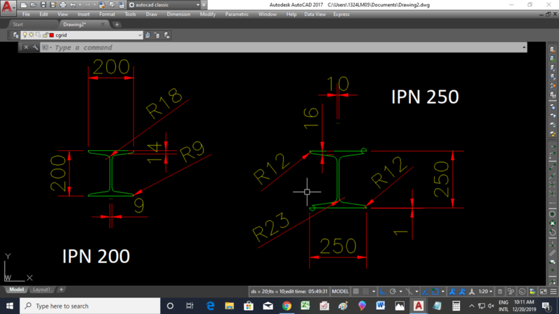

I have lisp dcl and data files working together to draw steel sections.
I have done all the sections modified to indian standards originally it was written for british standards and it is free of copy rights. Since the author has changed to catia 3 dacades before.
Please find attached images of error, dialog box and lisp files,data files and dcl files. This may looks like a big job. If any lisp expert available he can do it seconds. As I have done whole lot of things with minimum lisp knowledge.

What is the "ERROR", the label on the button? or the references to "UK" and "Euro" ? What should replace them?
Check forums/Autodesk and Theswamp before any one else answers. Was asked before I know responded.
Need to replace DAT files and maybe update labels in dcl. Or add a new collection. Look at file from other post.

For the error I think you should look at the IPN 250 profile in OP's 2nd image. The flanges have an incorrect 'bulge'.
Expand
Thanks @Roy_043 Totally missed that.
