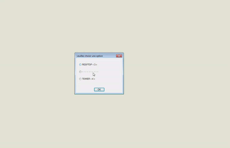

BIGAL Posted December 20, 2019 Posted December 20, 2019 (edited) Not sure but look at my multi radio buttons returns item ticked. Then use a cond to run correct defun. Multi radio buttons.lsp eg (cond ((= ans2 "±")(c:0)) ((= ans2 "Dimension")(c:1)) ((= ans2 "c/c")(c:2)) ((= ans2 "C/C")(c:3)) ) (if (not AH:Butts)(load "Multi Radio buttons.lsp")) (if (= but nil)(setq but 1)) (setq ans2 (ah:butts 1 "v" (list "Please choose" "±" "Dimension" "c/c" "C/C"))) Edited December 20, 2019 by BIGAL Quote
Sambuddy Posted December 20, 2019 Author Posted December 20, 2019 9 hours ago, BIGAL said: Not sure but look at my multi radio buttons returns item ticked. Then use a cond to run correct defun. As always BIGAL: you the man - My sincere thanks for sharing your work. I did similar conditions as I was overwhelmed with DCL tutorials. For some reason though I never thought about (c:1), (c:2) as answer but instead I changed my codes to fit what I intended (resulting in a 400 line code). I can clearly follow your logic of keeping my c:0 as is and then just reference it if the condition statement is true. da! You are a blessing on this platform! Thank you very much! Quote

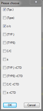

Sambuddy Posted December 20, 2019 Author Posted December 20, 2019 (edited) Hey BIGAL, I also just downloaded your Multiple Toggle Lisp. Could you please let me know how to deal with combination selection? (0 0 0 0 1 0 0 0 1 0 1) If I have lisp as you indicated on your last post c:1 11 hours ago, BIGAL said: (cond ((= ans2 "±")(c:0)) Can I still use condition with multiple selection? Would you help me please? say for example (Typ.) + c/c is selected - I do have the lisp to deal with it but I do not know how to make it know the combination. Do I use "nth"? Edited December 20, 2019 by Sambuddy Quote
BIGAL Posted December 21, 2019 Posted December 21, 2019 (edited) The toggle button returns 1 or 0 like a yes no. You can then look at using (nth x ans) so for you (nth 0 ans ) = (typ.) and will be a 1 or 0. Note nth starts at 0. (1 0 1 0 0 0 0 0 0 0 0) You can still use cond but to check for 1 or more you need and. (cond ((= (nth 0 ans) 1)(do-1)) ((= (nth 1 ans) 1 (do-2)) so repeat for single pick combo pick ((and (= (nth 0 ans) 1)(= (nth 5 ans) 1)(do-7)) ((and (= (nth 3 ans) 1)(= (nth 4 ans) 1)((do-12)(do-17))) ; run two defuns ) (and (= (nth 0 ans) 1)(= (nth 2 ans ) 1)(= (nth 3 ans ) 1)(= (nth 4 ans ) 1)(= (nth 5 ans ) 1)) worked Edited December 21, 2019 by BIGAL Quote

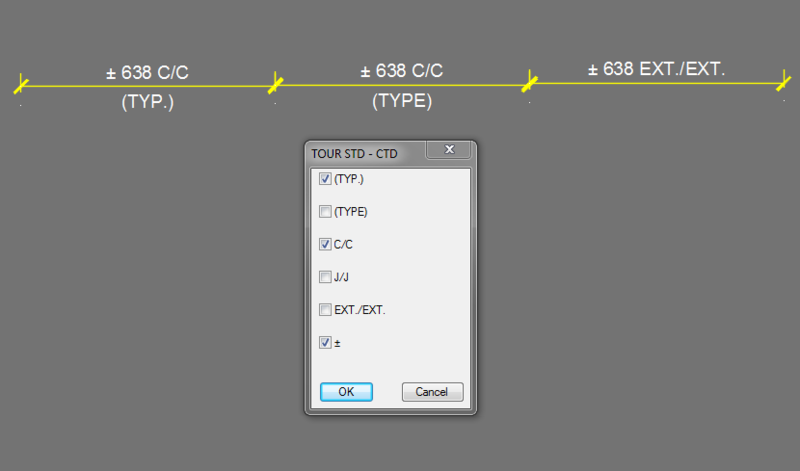

Sambuddy Posted January 2, 2020 Author Posted January 2, 2020 @BIGAL Thank you BIGAL for you help and guidance! I have now created a fancy DCL with your two multi and single selection DCL. It was a GREAT help. Please see attached picture - I am not sure a better way to create a spacer between my groupings. Do you think there is a way I can create a title or spacer? Again - I am amazed of what I was able to create with your help! Regarding the earlier question of loading LISP - it happens many times thatI bring the office laptop home and have to hard code the loading portion as I am not the one in charge office CAD related issues. Would there be a way to hard code two directories - none of which on the trusted search path? a) check path1 and/or B) check path2 and if not loaded, load Blah.lisp Thanks Quote
BIGAL Posted January 3, 2020 Posted January 3, 2020 (edited) You have answered your own question re spacers look up the dcl help for spacer you would just add to code, in multi radio buttons I did add a auto space see below you just need to make the list before doing the (setq ans part you then get the length of this list (length lst) and do say if less than 8 add spacer, remember its actually 6 as ver/hor & label are part of the list. I may not have posted that version. It was based around a user request. (write-line "spacer_1 ;" fo) (if (< numch 8) (write-line "spacer_1 ;" fo) ) (setq x (+ x 1)) ; look for this in multi radio buttons ) (setq lst '("Yes or No" "Yes" "No")) (setq numch (length lst)) (setq ans (ah:butts but "V" lst )) Thinking a bit more maybe add a padding to the text description say 2 spaces then remove when retrieving. You can also get which line was picked in radio buttons, so your cond etc would be more like was it 0 1 2 3 ? So the description is not used as the Text string to be checked. (nth but butlst) remove and (princ but) Lastly there is "text" in dcl I have not used it but you could add extra labels. Send a email to info@alanh.com.au may be easier than clogging up Cadtutor. Edited January 3, 2020 by BIGAL Quote

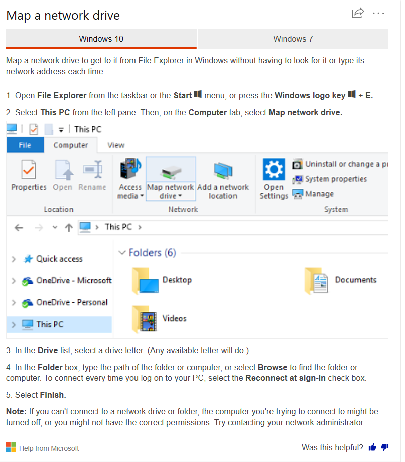

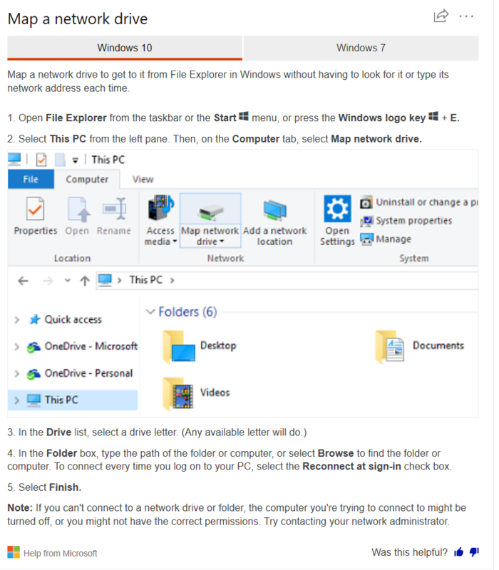

BIGAL Posted January 3, 2020 Posted January 3, 2020 (edited) Using the support paths is the easiest way and it does not matter if at work or at home if they don't exist Autocad will skip, Ok a simple way around maybe creating a trusted path is to map a drive but it can also be a directory so you could have a trusted path like L:\ for lisps on home computer. Thinking a bit more it could be the name of you network drive. Map a drive can be done at CMD (DOS) level so you could just do when you take it home to look on say a USB. Once turned pff its gone. The other way is you can add trusted paths via lisp, whilst you have trusted paths its so easy to get around it almost why do it. I guess also can remove. May be better here to use setenv and getenv if you close Autocad can get old back. I would setenv once only running the couple of lines of code, don't do each time then no chance of having wrong paths. (setq oldtrust (getvar 'trustedpaths)) (setq newtrust (strcat oldtrust ";" "L:\\Autodesk...")) (setvar 'trustedpaths newtrust) ; back to old (setvar 'trustedpaths oldtrust) (setvar 'trustedpaths (getenv "Trustedpaths")) Edited January 3, 2020 by BIGAL 1 Quote
