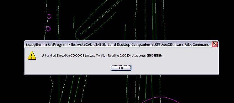

Okay, so were creating a digital terrain model (DTM) for a project. The file is a huge ongoing project. We are doing a miniture DTM that is about a 300 feet x 500 feet rectangle. We've done a lot of separate DTM's for this project without any problem. Yesterday and this morning we tried doing the DTM and we get these error messages.

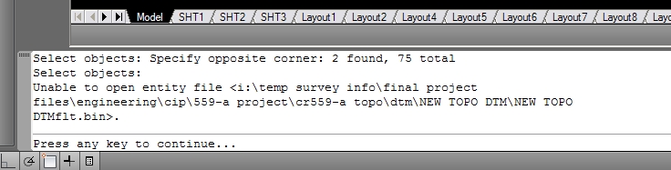

To get to this point we created our Boundary, and our point group. Brought that information into the Terrain model with no problem. When we go to grab the breaklines using "Proximity with Polyline" it grabs all the breaklines and then we get this error message. It then closes back out to the Terrain Model.
If we try again to grab the breaklines using the same method we get this in the command line.
This has been done on multiple computers and different days so I don't believe it's a PC problem. Any Ideas on how to fix this??

Audit and Purge won't help as they only deal with the .dwg. It appears that you are dealing with a problem pertaining to one of the external data files. It looks like the breaklines file since the filename ends in flt.bin which I think is where it stores breakline information. Did you check that folder to be sure that file was still there? If it is there it may have become corrupt. If it isn't there, where did it go?
