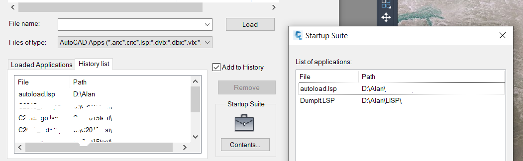

BIGAL Posted December 20, 2019 Posted December 20, 2019 Scottie Fox You are on the right track with the shortcuts you have in your post. I have a single library lisp that gets loaded at startup, I prefer this method to adding to Autocad default startup lisps that get loaded. So will keep going down this method. So make a lisp you can call it Scottie.lsp if you want, then type Appload, choose your Scottie.lsp and load it, this makes it available to only the current dwg. So next step is add it to Start up suite. Just click on it and add. Inside my autoload.lsp there are 40 short defuns and 34 autoloads. Tombu and I are talking about transparent commands these can be used in the middle of a command as example when doing pline you can type snaps like "end" "mid" or reset your osnaps by typing a apostrophe and the defun name hence Line '9 then pick a point with snap now set to end and node as per your post. At end to reset osnaps just type say 47 as a command (my defun) When writing programs and testing, osnap often gets reset so having a shortcut comes in handy to reset it back. Don't forget F3 is on / off 1 Quote

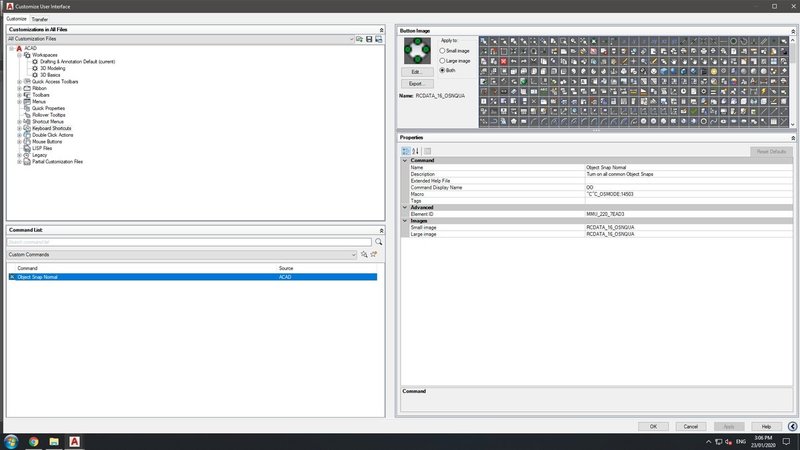

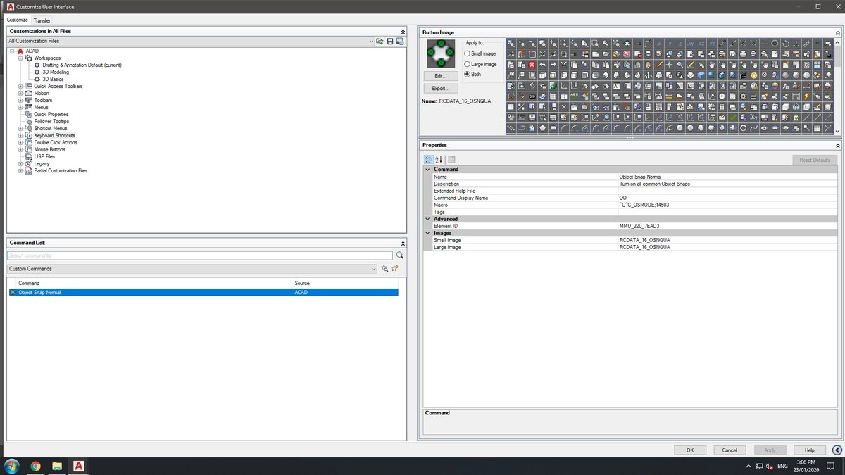

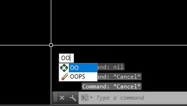

Scottie Fox Posted January 24, 2020 Author Posted January 24, 2020 Happy New Year to everyone! (I know it's late but I've been busy with other stuff at work). Anyway, I'm definitely not doing something correctly, lol. I tried following the instructions on here about creating a macro (see attached image), and I thought everything looked good. However, when I type the command (OO in this case) it appears on the screen (see other attached image) but then the "Oops" command is activated, completely skipping mine. The OSMODE part worked, but it's too much to type each and every time. Can someone please point out where I am going wrong? Also, does adding a macro add the command into my LISP file so it will work on all drawings, or do I have to do it for every drawing? Thanks again for all your help and time, you guys are awesome :) Quote
BIGAL Posted January 24, 2020 Posted January 24, 2020 Make your own lisp file as I suggested earlier, there is no reason why your desired snaps can not be like 1 2 3 4 as commands just checked appear to be not used. Command: 2 Unknown command "2". Press F1 for help. As offered earlier can do transparent commands, Line '2 pickpoint '4 pickpoint note the apostrophe before the number implies transparent use. or 2 then Line. Same with macros they can be simple or very long, generally for long code save as a separate lisp can use the shortcut to load it and run. Quote

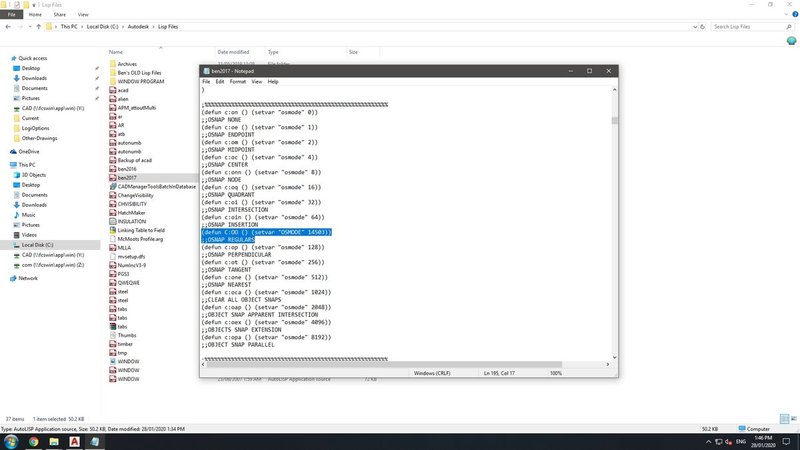

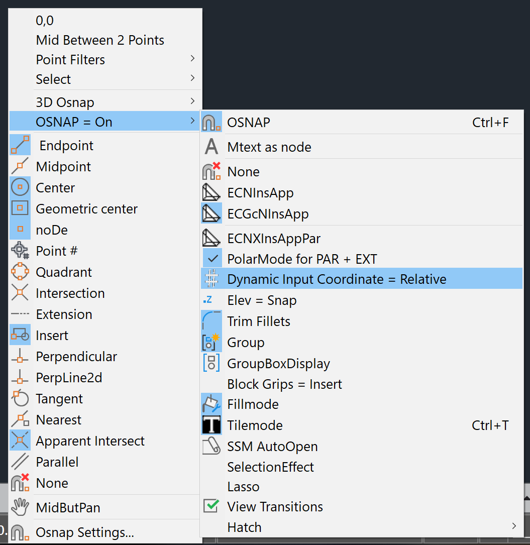

tombu Posted January 24, 2020 Posted January 24, 2020 Putting OO in as a Command Display Name doesn't make it a command. Easiest way would be to add (defun C:OO ()(setvar "OSMODE" 14503)) to your acaddoc.lsp file. I've modified our 'Object Snap Cursor Menu' with a flyout for commonly used Osnap settings and toggles for a few other settings as well. Quote
BIGAL Posted January 24, 2020 Posted January 24, 2020 (edited) Tombu I prefer to not to add to acaddoc.lsp 1st its buried deep directory wise, when you do an upgrade must redo acaddoc.lsp. It does not take much to use appload and add to startup only needs to be done once. My auto has like 25 defuns and same number of Autoload. Its on a server so everybody gets the update straight away if use Acaddoc have to go to every pc. Edited January 24, 2020 by BIGAL Quote
tombu Posted January 25, 2020 Posted January 25, 2020 I've never tried appload to be honest. There used to be lots of issues with it posted online but I haven't seen any in a while so they may have gotten the bugs out now. Don't you have to load every lisp in a dialog box for it to work? Sounds tedious to me compared to simply adding acad.lsp, acaddoc.lsp along with cuix, lin, mnl, pgp and other customization files with a batch file in a few seconds to the "roamablerootprefix" folder with each upgrade. Quote
BIGAL Posted January 26, 2020 Posted January 26, 2020 (edited) Your startup lisp can have autoload statements so when you type a command the lisp will load automatically. They need to be in support path. My "autload.lsp" has 25+defuns and about same autoloads. The other advantage was fornetwork of users only saved on the server so only ever one version. Same with custom mnu files. (autoload "COPY0" '("COPY0")) (autoload "COPYCOMMAND" '("ZZZ")) (autoload "COVER" '("COVER")) (autoload "DIMFLIP" '("DIMFLIP")) (autoload "DRAWXFALL" '("DRAWXFALL")) (autoload "DRAWPIPE" '("DRAWPIPE")) Other lisps are loaded from menu's or toolbars. Edited January 26, 2020 by BIGAL Quote

Scottie Fox Posted January 28, 2020 Author Posted January 28, 2020 On 1/24/2020 at 1:00 PM, tombu said: Putting OO in as a Command Display Name doesn't make it a command. Easiest way would be to add (defun C:OO ()(setvar "OSMODE" 14503)) to your acaddoc.lsp file. I've modified our 'Object Snap Cursor Menu' with a flyout for commonly used Osnap settings and toggles for a few other settings as well. Expand Hi, Tombu. I tried searching Windows for the "acaddoc.lsp" file you mentioned but couldn't find anything, so I presume this is just the name you use (whereas mine is currently called ben2017.lisp)? I tried adding that command as you suggested but it's still not recognising it when I type "OO"; I've attached a screen shot of the edited LISP file I am using in my Startup Suite. Where am I going wrong? I tried closing and reopening AutoCAD with no luck. Also, I found an online course which seems to deal with Macros and the like: https://www.udemy.com/course/practical-autolisp-programming-beginner-to-advanced/ What do you guys think? Would this be an ideal course for me to take? Cheers. Quote
tombu Posted January 28, 2020 Posted January 28, 2020 Some useful links: https://www.cadtutor.net/forum/topic/51506-acadlsp-and-acaddoclsp/ https://forums.autodesk.com/t5/visual-lisp-autolisp-and-general/acad-lsp-vs-acaddoc-lsp/td-p/883468 ACAD.lsp, ACADDOC.lsp, and ACAD.rx are user defined files, they aren't part of the program/install. If you want to have one, you can create your own. They were designed by AutoCAD to be helpful user files if we create them. ACAD.lsp loads automatically every time you open an AutoCAD session which is great for some things. ACADDOC.lsp loads automatically every time you open a drawing which is best for loading lisp you need all the time. If you place a list of arx files in ACAD.rx they will be automatically loaded as well. These files have obvious advantages over ben2017.lsp (lisp is not an extension). You need to understand TRUSTEDDOCDOMAINS and TRUSTEDDOCPATHS as well. Quote
Scottie Fox Posted January 29, 2020 Author Posted January 29, 2020 On 1/28/2020 at 12:31 PM, tombu said: Some useful links: https://www.cadtutor.net/forum/topic/51506-acadlsp-and-acaddoclsp/ https://forums.autodesk.com/t5/visual-lisp-autolisp-and-general/acad-lsp-vs-acaddoc-lsp/td-p/883468 ACAD.lsp, ACADDOC.lsp, and ACAD.rx are user defined files, they aren't part of the program/install. If you want to have one, you can create your own. They were designed by AutoCAD to be helpful user files if we create them. ACAD.lsp loads automatically every time you open an AutoCAD session which is great for some things. ACADDOC.lsp loads automatically every time you open a drawing which is best for loading lisp you need all the time. If you place a list of arx files in ACAD.rx they will be automatically loaded as well. These files have obvious advantages over ben2017.lsp (lisp is not an extension). You need to understand TRUSTEDDOCDOMAINS and TRUSTEDDOCPATHS as well. Expand Hello, again! Thank you for the links and additional information; I'll definitely do some further reading and will likely watch that tutorial series I linked also. In the meantime, would it be possible for you to create an ACADDOC.lsp file for me with the macro / command I'm after then send me instructions / screen shots on how to activate it? At least this way I'll have an actual working example to work with and learn from? Quote
