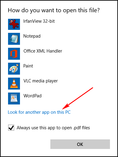

When I right-click and select "open with," because I have 3 versions of AutoCAD on my computer, it gives me 3 AutoCAD applications to choose from. However, it doesn't tell me which version is which, they all just say "AutoCAD Application". So I figured I'd try each one to see what version it opens... they all opened the same version I'm assuming there is another default setting somewhere i'm not sure. How do i select the version by the correct year? I'm thinking i just have to delete the other programs and reinstall but there has to be an easier way.
Use the open with right click option > Scroll down to "More apps"
navigate to the exe of the AutoCAD version you want.
