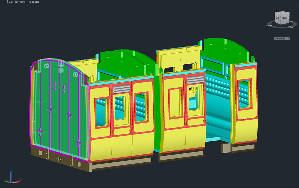

II finally redrew the complete drawing from scratch. I am convinced there was a corrupt section of the file stopping me from exporting it correctly. Finding the corrupt bit was not possible. During the redraw I kept unionising all the components and exporting them at various stages to ensure all was well.
The drawing is a railway coach. Basically I have drawn a single compartment, an end detail model and a split compartment. I need the split compartment as the final model is to have eight compartments and the maximum size I can 3D print is four and a half compartments. It was better to split the model at  door hinge line to hide the joint line.
This is the AutoCAD 3D model of the three sections, an end detail section, a full compartment, and a split compartment.

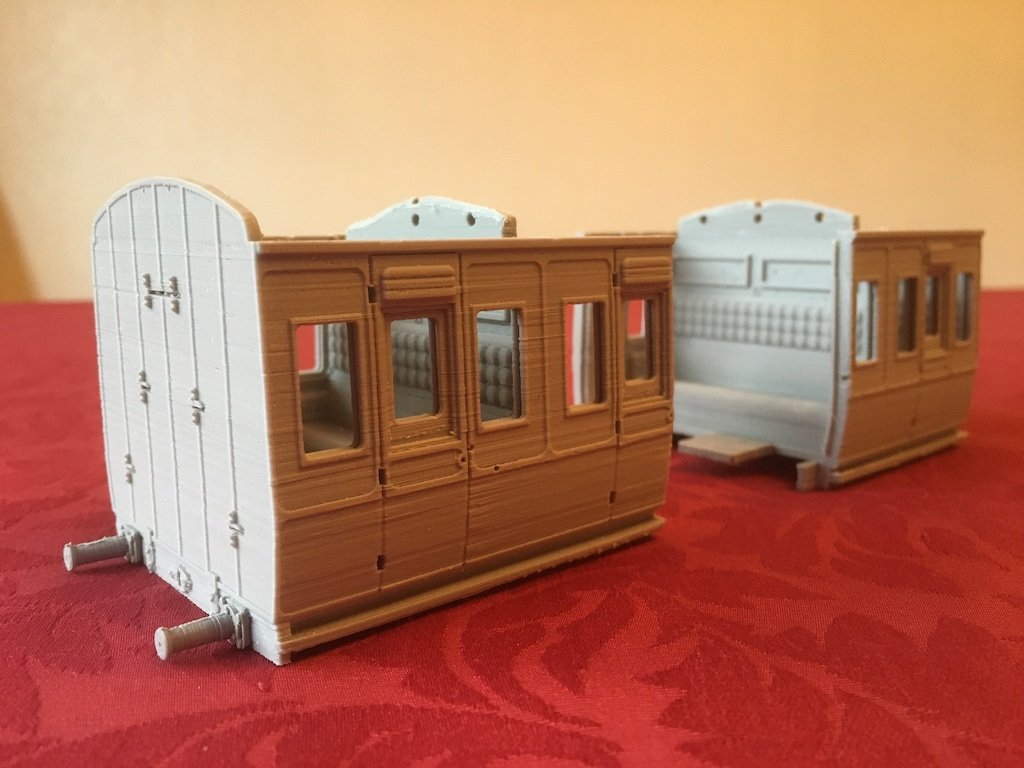

When 3D printed the three sections look like this. The buffers are a separate print as they are better when printed vertically.
and when put together and a 3D printed roof added
These are only test prints. A few things require modifying before I go to print the full eight compartment coach.

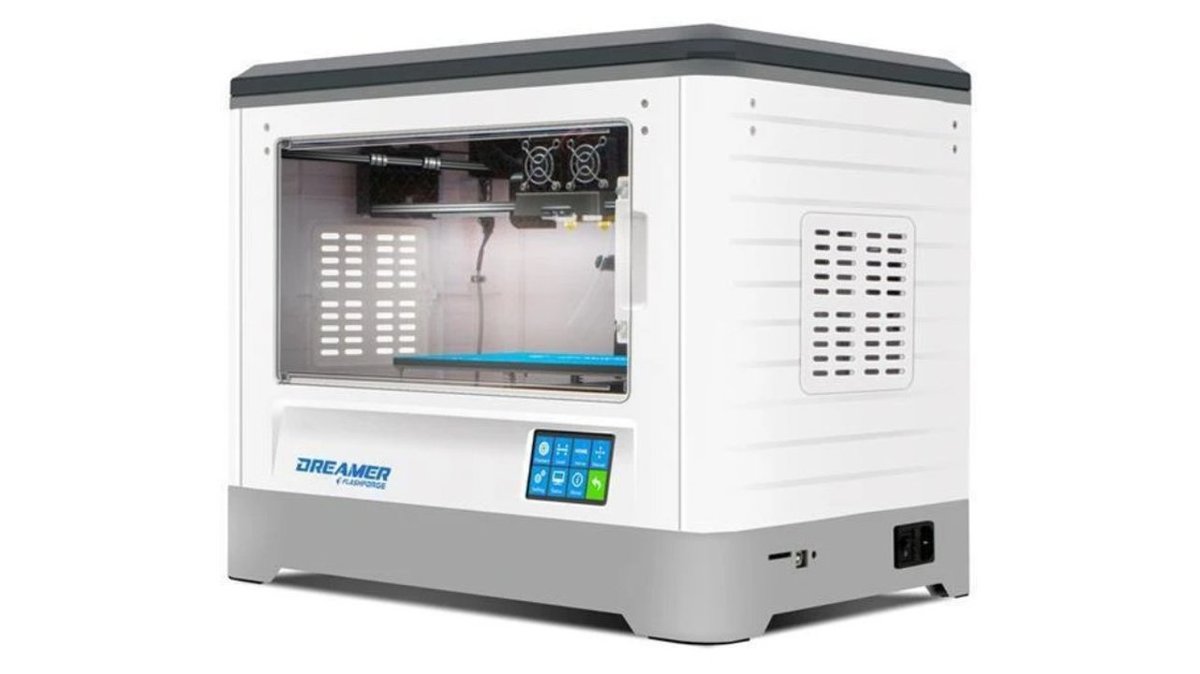

What printer are you using?
Flash forge Dreamer and Simplify3D slicing software. Final prints will need a bit of cleaning up to get a smoother finish.

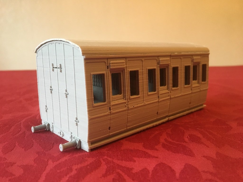

To complete the story this is the final print of the LNWR coach. My printer will only print a maximum length of 250mm hence the body is two parts, as is the roof. The finish is not brilliant as one would expect from this type of printer, but it has been cleaned up quite a lot. Still more to do. The buffers are now separate items in order to print them in a different orientation. Black components beneath the coach are all separate prints located in slots in the floor. Slots on the coach side are for hinges made from plastic strip which will be glued in position. The slots on the end are for steps. The roof is held in position by small handrails on the end of the coach. Not prototypical but it will suffice for now. After some more cleaning up it will be ready for the paint shop.
