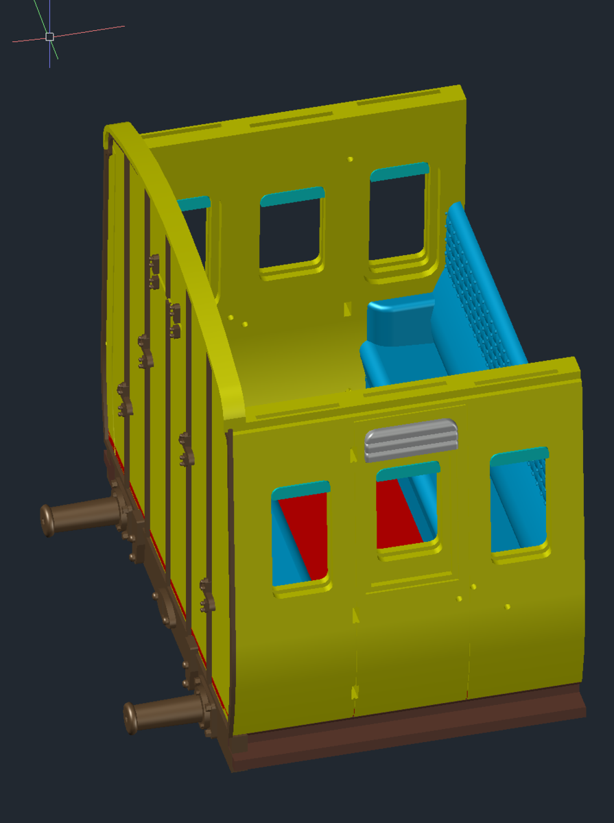

The first picture shows a compartment for a model railway coach.
1279831158_Screenshot2019-12-16at17_27_31.thumb.png.e2572ae9265046024a5aa56c9023b38e.png

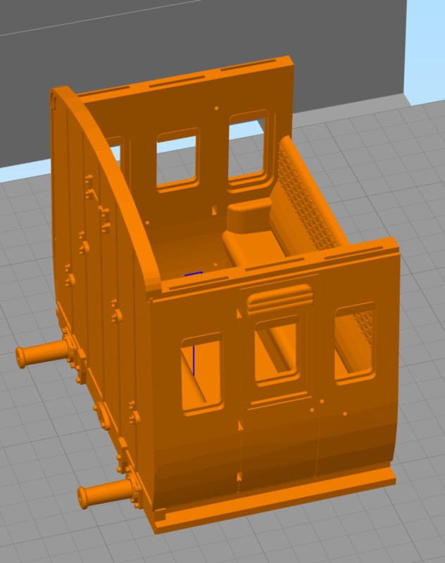

When exported the stl file is then imported in to a 3D printing programme. The result is good.

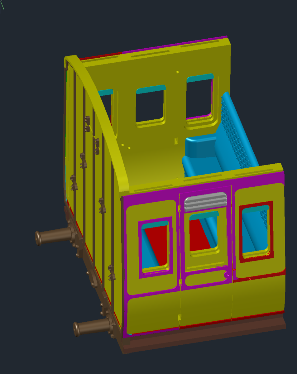

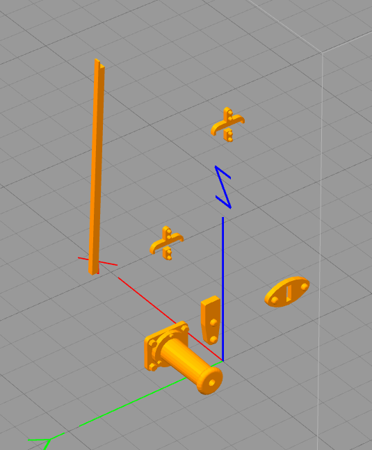

I then add another component to the outside of the coach as shown below.
480249440_Screenshot2019-12-16at17_27_45.thumb.png.1b1f2a78ef5d3d44bdb672814ee15826.png

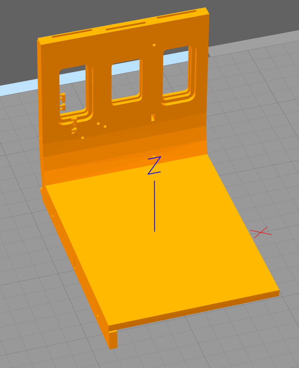

When imported into the 3D printing software some components are missing.
962048854_Screenshot2019-12-16at17_31_39.thumb.png.8a551ec37eb6cf8e6900282a386106f8.png
The problem is in the exporting to the STL file. I am just using the 3D software to illustrate the resulting STL file. I can export most components successfully, it is only a combination of components that cause the problem of missing components. It seems to be random as to which components result in the errors. I have tried redrawing some of the components that I thought could be causing the problem to no avail. I am convinced there is some sort of corruption within the AutoCad drawing but I am having trouble finding what is wrong.

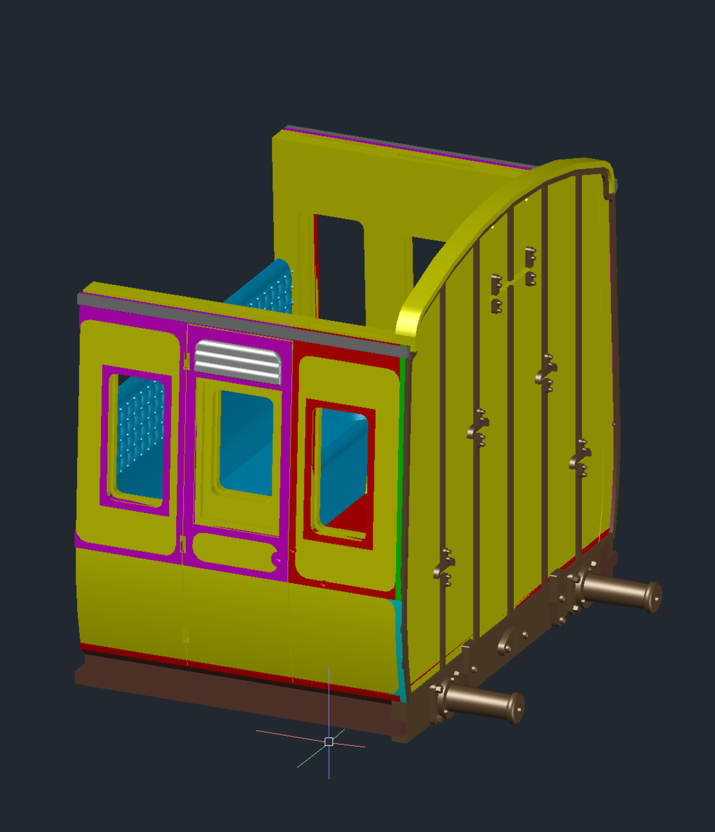

I have reduced my dwg file to just the relevant layers. As shown below is the dwg file in AutoCad.
1516333998_Screenshot2019-12-18at14_19_08.thumb.png.17c7e889fa41dd066b780c62bdcbf4de.png
Once I select all the components and export to an stl file the resultant stl file does not contain all the components.
Tried to union all the components in each layer in turn and then unioning with the previous layer. The stl file was OK until the union failed with the following error “Modelling operation error, the Boolean operation on solid and/or surface bodies failed, error code 84028”. When the union failed I tried unioning in a different layer order. The failure did not occur at the same layer. Once the union fails then the stl file will not export correctly.

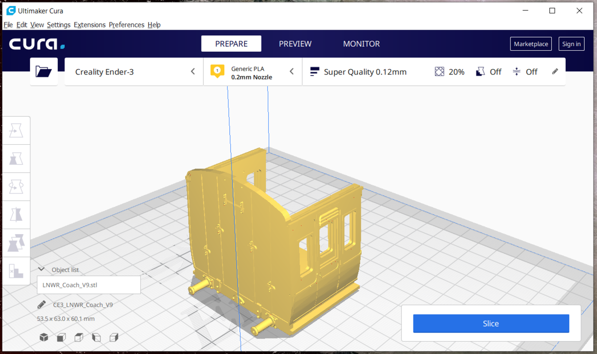

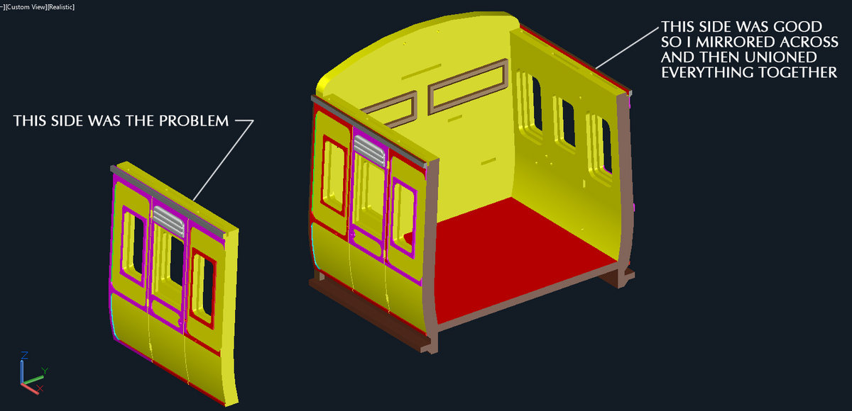

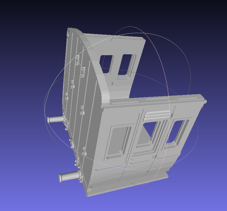

I was able to union everything together, except for one side of the model which would not cooperate. So I moved it out of the way and mirrored the good side across to the other side. Then I was able to union the whole thing and export to .stl. I imported the .stl into Meshlab to check it out, (see image below), and everything is there. By the way Meshlab is a free program and it's very useful for importing and viewing many different file types. You might want to download a copy.
I have attached the unioned .dwg file and the .stl file.
LNWR_Coach_V9-Unioned.dwg LNWR_Coach_V9.stl
I can't do that! I can union the model when I leave out both sides. When I do try to union the whole thing it doesn't union anything, so how did you latch on to the one side  been the problem?
I may try deleting the two sides and redrawing the two sides.
Downloaded  Meshlab. Looks good so far but quits unexpectedly when I try to import some  of my stl files. Probably settle down as I get used to it.
I did have some trouble with the Union of certain objects, so I ended up doing a series of small Union's, building up the model as I went along. When I tried to Union everything at the same time it didn't work. And that one side of the model wouldn't cooperate so I got rid of it, then I Unioned the other side and mirrored it across.
