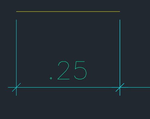

I have this points with his line:
(setq p1 (getpoint "\nPunto Inicial:"))
(setq p2 (polar p1 0 0.5))
(entmakex (list '(0 . "line") (cons 10 p1) (cons 11 p2) '(62 . 2)))
How can I make dimensions of this?
with the same caracteristics of the image below
Thanks for help.

Perhaps the easiest way to create the dimension would be something like:
(defun c:test ( / ln p1 p2 )
    (if (setq p1 (getpoint "\nPunto inicial: "))
            (setq p2 (mapcar '+ p1 '(0.5 0 0))
                  ln (entmakex (list '(0 . "LINE") (cons 10 (trans p1 1 0)) (cons 11 (trans p2 1 0)) '(62 . 2)))
            (command "_.dimlinear" "" (list ln p1) "_non" (mapcar '+ p1 '(0 -0.5 0)))
This approach also has the advantage of creating an associative dimension.
The appearance and measurement formatting should be controlled by your Dimension Style.
Edited by Lee Mac
  • Thanks 1
6 hours ago, Lee Mac said:
(if (setq p1 (getpoint "\nPunto inicial: ")) (progn (setq p2 (mapcar '+ p1 '(0.5 0 0)) ln (entmakex (list '(0 . "LINE") (cons 10 (trans p1 1 0)) (cons 11 (trans p2 1 0)) '(62 . 2))) ) (command "_.dimlinear" "" (list ln p1) "_non" (mapcar '+ p1 '(0 -0.5 0))) ) ) (princ)
But if the line is a variable, it will not always measure 0.5. How would it be in that case? Because this variable will be written by the user with this:
(setq l1 (getreal "\nLongitud de Apoyo:"))
Its not a number exactly. Its a variable....
I dont want that make a line also. Just the dimension, because I already have the line drawed.
thanks for your help again @Lee Mac
Edited by danyra
