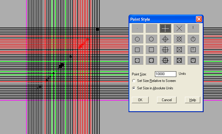

One way of deleting the points is to format them as crosses, and size them as 10000 (or bigger) absolute units. The points will spread out wider than any detail and you can erase them all with a crossing window.

I was responding to your original request about deleting points. Blocks is different.

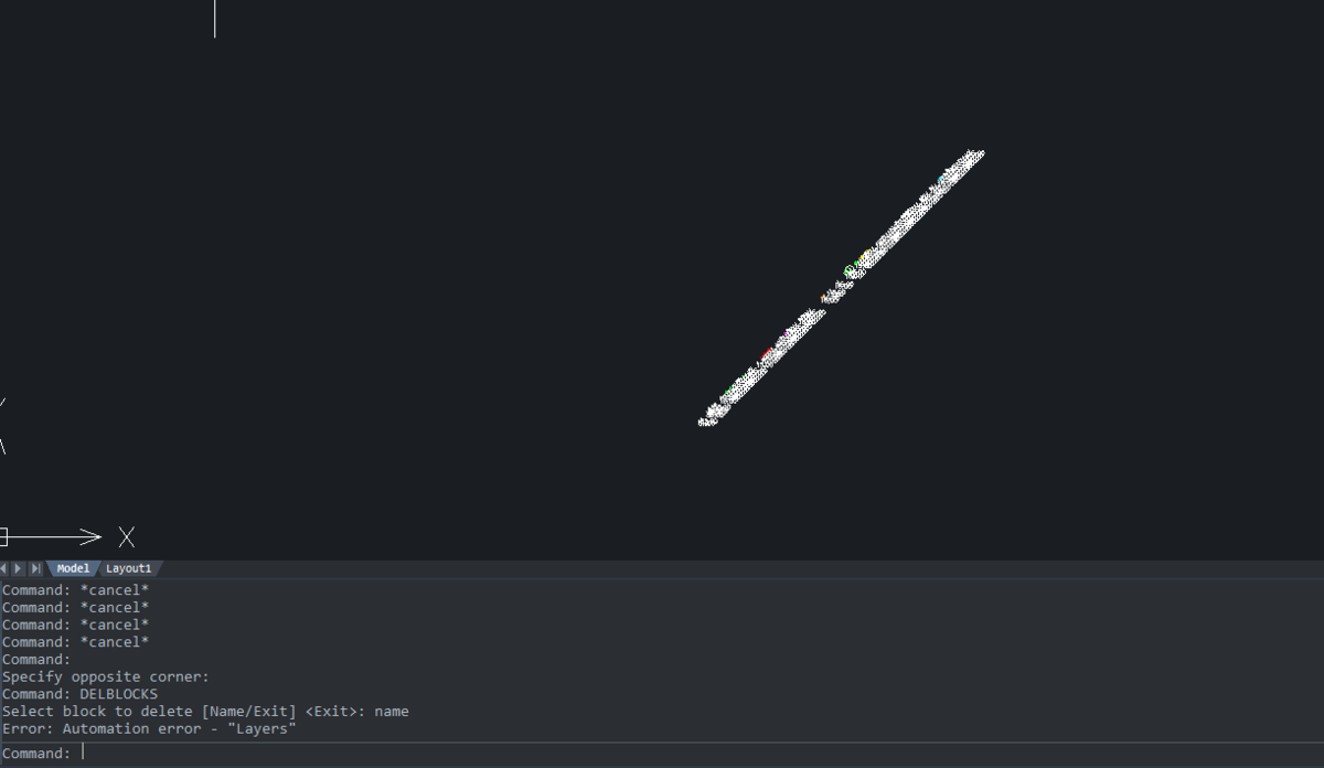

zwcad im going with, dosent work there! i get the menu up but an error after marked all the blocks i want to delete

I cannot guarantee the compatibility of any of my programs within ZWCAD; out of interest, what error do you receive?
