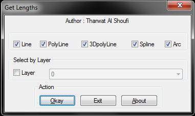

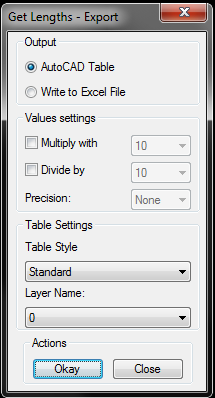

Tharwat Posted December 13, 2019 Share Posted December 13, 2019 Here is another free program that get lengths of curve objects and export the result into AutoCAD or Excel file .csv along with a bit good options. https://autolispprograms.wordpress.com/get-lengths-program/ Quote Link to comment Share on other sites More sharing options...
BIGAL Posted December 13, 2019 Share Posted December 13, 2019 Very nice asked for all the time on the forum. Missing circle ? Arc/Circle ? Quote Link to comment Share on other sites More sharing options...
Tharwat Posted December 14, 2019 Author Share Posted December 14, 2019 Thank you, Circle object was not forgotten but since it does not have length property I omit it and it has just a perimeter as you know. Quote Link to comment Share on other sites More sharing options...
Ish Posted December 14, 2019 Share Posted December 14, 2019 Is it will write length text on line object also.? Quote Link to comment Share on other sites More sharing options...
Tharwat Posted December 14, 2019 Author Share Posted December 14, 2019 Just now, Ish said: Is it will write length text on line object also.? No, but the outcome would be in acad_table or excel file ( *.csv ) based on the desire of the user. 1 Quote Link to comment Share on other sites More sharing options...
