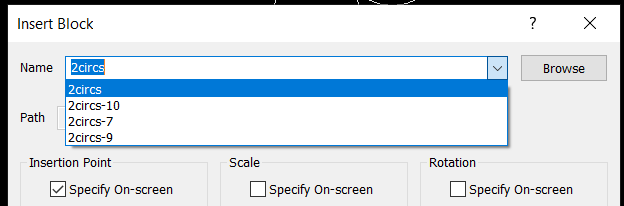

sketch11 Posted December 12, 2019 Posted December 12, 2019 In AutoCAD you can insert objects from another drawing as a block, using a pull down menu. In this project, I have a number of files corresponding to steel sections, 1 file per section. There are the MNU and script files in the same folder (see attachments). The issue: If I insert in a drawing, the name of the block seems to take the name of the file. I want to change it to a random name such as "A$C7ABC15J1". The reason is that if I insert the same Section in two separate drawings, and edit the blocks in different ways, and then copy/paste between each other, the appearance does not carry over. Reason is that they have the same name. This may be confusing so don't worry if it doesn't make sense. I just need to have a random name. Exploding and re-pasting as a block is a nuisance and at times I do forget to do this. STRUCTURAL_STEEL.mnu STRUCTURAL_STEEL.scr Quote
BIGAL Posted December 12, 2019 Posted December 12, 2019 (edited) Rather than obscure names as part of menu I would change your insert to a lisp so it could check if block exists, if so look for -x ie add -1 to block name so insert 3 times block name is UB125-3 you would rename 1st block to say -1 then insert UB125 and rename. Need to have a think about it. -Rename block blockname newname note all blocks of this name in dwg are renamed. [->UB] [610UB125]^C^C(blkins "610UB125") [610UB125]^C^C(if (not blkins)(load "blkins"))(blkins "610UB125") Edited December 12, 2019 by BIGAL Quote

BIGAL Posted December 18, 2019 Posted December 18, 2019 Should work not tested but every time ran will make x + 1 to test copy this to command line (setenv "ub" "0) ; only needed to set seed X can be reset any time each dwg ? (setq x (atoi (getenv "UB")))(setenv "UB" (rtos (+ x 1) 2 0)) -INSERT UniversalBeams_610UB125;scale;1;(getreal)(command "-rename" "block" "UniversalBeams_610UB125" (strcat "UniversalBeams_610UB125" "-" (rtos x 2 0)) Simplest way is a defun passing block name. ^c^C(blockins "UniversalBeams_610UB125") Quote

BIGAL Posted December 18, 2019 Posted December 18, 2019 Try this it will keep adding numbers at any time to reset number so (setenv "UB" "0") it can be changed to have a separate UB ANG UC CHS etc number. You will need to load it 1st so simplest would be to add to your menu as a ^c^c(load "blkins") or else add to autoload. ; insert a block make a new block with name + 1 ' By Alan H Dec 2019 info@alanh.com.au (defun blkins (blkname / x temp) (if (tblsearch "BLOCK" blkname) (progn (alert "Block of that name already exists\n \nwill temporary rename") (command "-rename" "block" blkname "tempblk") (setq temp 1) ) ) (if (= (getenv "UB") nil) (setenv "UB" "0") ) (setq x (+ (atoi (getenv "UB")) 1)) (setenv "UB" (rtos x 2 0)) (command "-INSERT" blkname (getpoint "\nPick insertion point") (getreal "\nEnter scale") "" (getreal "\nEnter rotation")) (command "-rename" "block" blkname (strcat blkname "-" (rtos x 2 0))) (if (= temp 1) (command "-rename" "block" "tempblk" blkname) ) ) ;^c^c(blkins "UniversalBeams_610UB125") Quote

BIGAL Posted December 20, 2019 Posted December 20, 2019 (edited) This is what your menu lines should look like I added one line for testing, you must copy and paste the code to notepad and save Blkins.lsp to a supported Autocad path, or else edit the (Load "c:\\yourdirectory\\your path\\etc\\Blkins") to suit, you can give it any name you like, just match. So pick "Load blocks" only need to do once. ***MENUGROUP=STRUCTURAL_STEEL ***POP12 **CTOPopSTRUCTURAL_STEEL [Structural Steel] [load blocks]^c^c(load "blkins") [->UB] [610UB125Test]^C^C(blkins "UniversalBeams_610UB125") [610UB125]^C^C-INSERT UniversalBeams_610UB125;scale;1; [610UB113]^C^C-INSERT UniversalBeams_610UB113;scale;1; [610UB101]^C^C-INSERT UniversalBeams_610UB101;scale;1; [->UC] [310UC158]^C^C-INSERT UniversalColumns_310UC158;scale;1; [310UC137]^C^C-INSERT UniversalColumns_310UC137;scale;1; [310UC118]^C^C-INSERT UniversalColumns_310UC118;scale;1; [310UC96.8]^C^C-INSERT UniversalColumns_310UC96.8;scale;1; Blkins.lsp Edited December 20, 2019 by BIGAL 1 Quote

BIGAL Posted December 22, 2019 Posted December 22, 2019 (edited) Remove the Alert line Remove the two getreals and replace with 1 and 0 Are you setting oom somewhere ? else just (setvar 'osmode 47) or your preferred value don't need if. If you crash it should run again choosing menu. Edited December 22, 2019 by BIGAL 1 Quote
