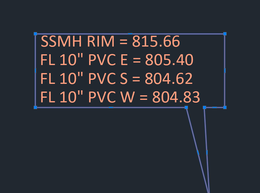

is there a way to make a leader style like this?
right now its just a polyline around the text, the survey we get has them set up like this.
You could probably write a LISP routine to draw the border, but it wouldn't be a true multileader.
Using a dynamic block could be done. You make the leader part a visibility state.
Civ3D does this for some label styles but at times it just not right.
I did a circle, text inside then leader went from centre to point and was trimmed at circle edge so line was radial, could be done for the image shown. Like Cyberangel a lisp.
