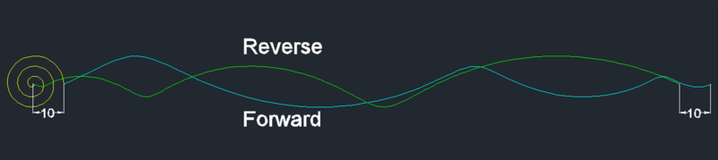

On 12/15/2019 at 10:19 PM, marko_ribar said:
I am wondering are those methods any good for HELIX curves ??
maybe 'stretch' rescale x-direction? something like a wave graph? Just $0.02 idea sorry if not practical 😛
2D illustration purpose only, it does not present actual scale of wave 'frequency' pattern
Edited by hanhphuc
new img & comments

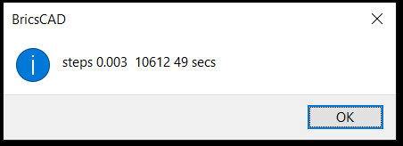

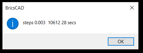

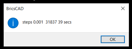

Using roy script even though its a bit slow 10000+ steps still workable did not hit minutes. Might shave a few here and there see images.
Used entmake line
Vla-delete entlast
Not worth the time of trying to shave any more off.
For fun
Edited by BIGAL

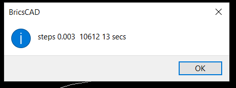

Used entmake line
Vla-delete entlast
For fun
With Newton-Raphson method.
Yeah a bit of a difference I always knew the trim method would not be fast. Just did it for the fun.
