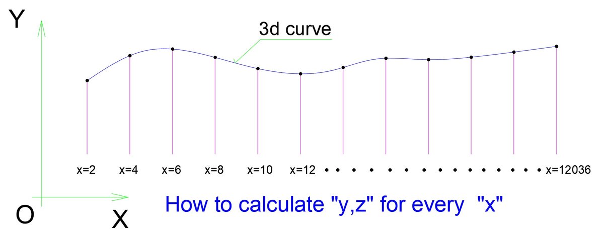

I have a 3d curve in autocad from x = 108 to x = 12064. I would like to calculate y, z for x = 108, 110, 112, 114,........12064, with dx = 2.
You still need to explain more for any one here to help, at least an image of the curve.

Here's my code, where I used the bisection method. I am waiting for a point of view from you.

Forget code show us a picture with out that we have no idea what it is your trying to do.
I now see what you want to do.  In short you a searching for the spline's parametric value that corresponds to a specific value of x.
Your program appears to work well assuming that the spline is a monotonic function in x. If there are multiple points on the spline for a value of x you will only get one of them.  If the spline swings out before the beginning of the spline or beyond it the points on these sections will not be determined (of course this cannot happen for monotonic functions).

I agree with lrm for what he stated, but then again, I don't know what method to suggest you that is fast enough and that covers those issues lrm mentioned... Maybe one that is not so slow but the code should be bigger :
1. You flatten your 3D curve
2. You construct XLINE with point at relative X coordinate 0.0 and with direction (0.0 1.0 0.0) - X coordinate must be smallest one - so suggested method of finding this point is by using (vlax-curve-getclosestpointtoprojection curve '(-1e+99 -1e+99 0.0) '(0.0 1.0 0.0))
3. You find intersection point of XLINE and flattened curve (there may be more than 1)
4. You construct XLINE from intersection point(s) you found in step 3. with direction (0.0 0.0 1.0)
5. You find intersection point(s) of XLINE from step 4. and your curve in 3D
6. You remove both helper XLINES and repeat from step 2. with point at relative X coordinate incremented for dx
You loop 2-6 all until no intersection points found in step 3.

As related to Marko’s ‘flatten’ suggestion, the 3d Curve could be linearized.  Copy the 3d Curve.  Step through every control point and remove the Y and Z components.  The resultant spline (probably even 3d Poly) will be a straight curve aligned to the X axis.  More importantly, it will have the same parametric span as the original.
On that straight curve use vlax-curve-getParamAtDist for a desired X location.  Take that parametric value and evaluate the 3d curve via vlax-curve-getPointAtParam to retrieve the Y and Z components.

I think that SEANT approach may be bingo for monotonic 3d curves, but still I'd rather suggest you using flattening to 2d - this way you are loosing only 1 dimension (remove all z components)... Because of loosing 2 dimensions like SEANT suggested, his method may fail with curves like HELIX or similar...
