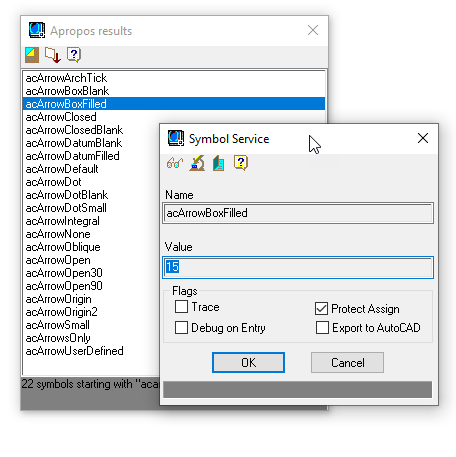

There is also this:
FYI - you can also search for "ArrowheadType Property (ActiveX)" in AutoCAD help. It will give you all the enum variables, which you can use rather than the integers.
