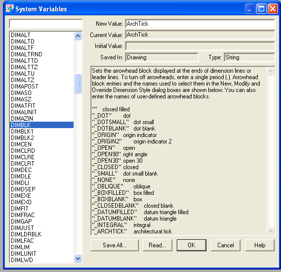

ronjonp Posted December 11, 2019 Posted December 11, 2019 Quick test and setting the DIMBLK variable as pointed out by @eldon imports the appropriate block. Maybe something like this: (defun _importarrowheadblock (n) (or (tblobjname "block" n) (= 'str (type (vl-catch-all-apply 'setvar (list "DIMBLK" n))))) ) (if (_importarrowheadblock "_BOXFILLED") (vla-put-arrowsymbol newleaderstyle "_BOXFILLED") )  2 1 Quote

ronjonp Posted December 12, 2019 Posted December 12, 2019 13 hours ago, BIGAL said: Yeah found it to change a pre created.  (setq obj (vlax-ename->vla-object (car (entsel "pick object ")))) (VLA-PUT-ARROWHEAD OBJ X) ; default is x=0 tick = 5 For a dimension  Arrowhead1Type = 0, Arrowhead2Type = 0   There is also this: Quote
