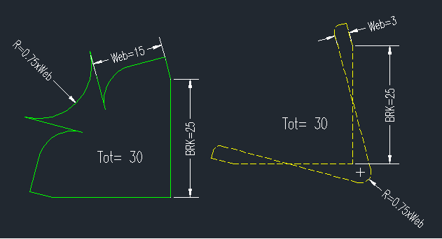

I am trying to make this work but sometimes it works and sometimes does not.
Please bare in mind that I just learned POLAR function and it may not the efficient way.
The radius through fillet I am choosing sometimes works but sometimes comes up with an error that radius is too big.
Is there another way to deal with drawing this or could there be a way to add arc without fillet?
could someone also please explain the ssget function and how I can select any object i create and store under a variable?
say, in this case I want to select all my lines: how would I do it?
Please describe with some details so I can learn.
Thanks
> when command drawing line, make sure "_non" (setvar 'osmode 0)
> you need to calculate filletrad before command fillet
> entmake lwpolyline - populate point list with bulge value: (list (cons 10 point ) (cons 42 bulge )) ,or vla-setbulge
>  LM ssget
> (setq ss (ssget '((0 . "LINE"))))
Thanks
Expand

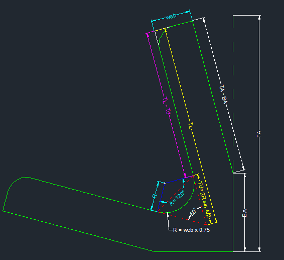

For fillet rad1 (R), try it yourself - recalculate polar angle as well as bulge value
1. find intersection point to get TL (from leg till red triangle)
2. find Td = 2r x sin (A/2) , A=120° , since it's a 3x60° triangle, i.e: Td = chord length (both is identical)
3. next polar (angle at TL) +135° with distance (TL-Td)
4. setbulge at nth vertex
Edited by hanhphuc
add dtr function , img & additional comments in red
Thank you hanhphuc for your explanation. It is greatly appreciate it. I am sure i will use your instructions on my other codes - thank you for putting some effort to even drawing the angle with labels!
Expand
It's glad you make good use of this forum posting your own code for discussions!  This is fine which we are willing to share ideas & suggestions.
Due to i'm not familiar to your design criterial so I just assume the input sequence from larger to smaller value, i.e: Angle size -> Break distance -> Web thickness.
In the example I use and , iniget to avoid inputting invalid values like negative zero, you can set the rules to avoid error using logical if or cond.
we'll be happy to see your progress & improvements!
p/s: I edited previous comment which is not A+135° confusing, it should be angle at TL+135°
@hanhphuc:
You have:
Td=2*R*sin(A/2)
I would say this should be:
Td=R*tan(A/2)
  • Thanks 1

  On 12/12/2019 at 8:21 AM, Roy_043 said:
@hanhphuc:
You have:
Td=2*R*sin(A/2)
Td=R*tan(A/2)
Expand
thanks @Roy_043  yes it should be the correct way for tangent length Td=R*tan(A/2). i should have explained correctly.
The reason i used Td=2*R*sin(A/2) due to OP's angle applied angle is 60°, it equals to Td=R*tan(A/2) only applicable if A=120° with chord 60°x3 (red triangle) which i previously mentioned chord length & Td length both indentical.
(setq R 1)
(* 2 R (sin (dtr (/ 120 2))))
;1.73205
(* R (tan (dtr (/ 120 2))))
;1.73205
i apology for the confusions. Hope OP will take note too dealing with angle out of 60° criteria :)
