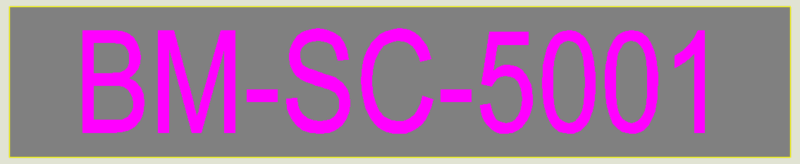

Hey guys,
I am trying to create a label (see attached dwg) using lisp to;
upon entering the command:
1) ask for prefix then keep this prefix in memory (in this case BM-SC- let's say)
2) I would just enter the number associated with any block until i change my prefix
3) create a block with the criteria (dwg attached) and attributes so I can edit the text if need be
4) simply insert it on paperspace
5) also to auto adjust the box width so it remain a certain width but if it exceeds blah mm then to fit and center text within the maximum box size instead of extending the box.
I do not know where to begin or how to handle this.
Is it even possible with a lisp to accomplish all this?
I do have this as a dynamic block but it seems to be a redundant task after a dozen paste - I have to fit the text or adjust the box.
Thanks
label.dwg
This is the extent I could succeed on the text insertion, numbering and prefix. Can anyone help me with creating a box and hatch for this label lisp please?
I did look at LEE MAC (BT) command but cannot seem to be able to combine the two + hatch the label.
and a general question: Can anyone in a few lines explain the ssget function and how to select entities that you create within the same lisp? It seems that I keep needing this function for my lisps but do not understand how it works!
Thanks

Use HELP inside Autocad look at lisp programming.
Just google ssget and look for \Autodesk in title for me it was the 1st entry.
Lee-mac has a excellent tutorial on some of the other ways of using ssget.
(ssget "selection method" "filters")
Section of code changed the clue was to look for the WHILE using Notepad++ found end of while and added the hatch at that point. Be careful if use solid white on white you will not see anything.

I found another way to deal with my label issue - your instructions are too high tech at this point for me as I am dealing as I even have problems with elementary stuff sometimes.

I wanted to make it more automated than once to add tags, once to use Tcircle, and anothertime to hatch the box. because of my stone age attempt on my codes after I posted my question, I did manage to accomplish all that (but I am ashamed of posting my code - it may look VERY dumb when some senior programmers look at it). But it has all worked out.
