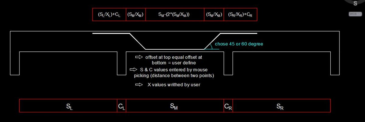

Abdulellah Posted December 9, 2019 Share Posted December 9, 2019 Before anything, I would like to salute Mr. Begal. All of my friends in the office are very pleased with the support you provided to them in the previous program. I hope you will provide us with a final service by writing the program shown in the picture. We are thankful to you. Quote Link to comment Share on other sites More sharing options...
BIGAL Posted December 10, 2019 Share Posted December 10, 2019 (edited) Good one to have a go at writing yourself. Pick pt1 pt2 these are your base points, then using the polar command work out the other points its very straight forward. Just wok out 1st a point above the base line with dist = cover, then left point 3 and so on. Last is (command "pline" pt5 pt4 pt3 pt6 pt7 pt8 "") (setq a45 (* pi 0.25)) (setq a90 (/ pi 2.0)) (setq a30 (* pi (/ 1.0 6.0))) (setq a60 (* pi 3.0)) (setq dist (/ hordist (cos ang)) ; take horizontal distance convert to slope distance. Writing this one yourself will make it easier to write even more rebar styles. Edited December 10, 2019 by BIGAL Quote Link to comment Share on other sites More sharing options...

BIGAL Posted December 11, 2019 Share Posted December 11, 2019 That's the idea make a start, it really is not that hard. (setq oldsnap (getvar 'osmode)) ; save the current osnap mode (setq ent (entget ( car (entsel "\nPick point bottom line")))) ; pick bottom line use snap like near and mid (setq pt1 (cdr (assoc 10 ent))) (setq pt2 (cdr (assoc 11 ent))) (setq ang (angle pt1 pt2)) ; angle of line (setq len (distance pt1 pt2)) ; length of bottom line (setq pt1 (Polar pt1 ang (/ (distance pt1 pt2) 2.0))) ; sets pt1 /2 way along (setvar 'osmode 128) ; set snap to perp (setq off (getreal "\nEnter the cover")) ; enter value of concrete cover (setq pt1 (Polar pt1 ang off) ; new point above bottom line (setq pt2 (getpoint pt1 "\nPick point top line")) ; pick pt2 (setq dist2 (- (distance pt1 pt2) off)) ; dist between bars (setq pt2 (Polar pt1 ang dist2)) ; point 2 at top minus cover keep going for other points using polar and angles as per previous post Quote Link to comment Share on other sites More sharing options...

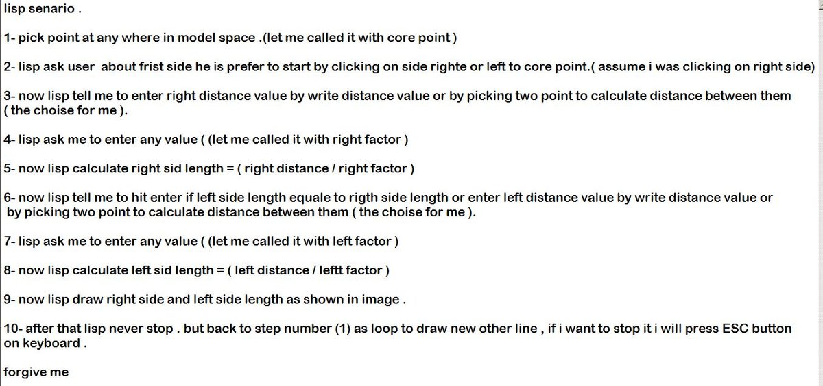

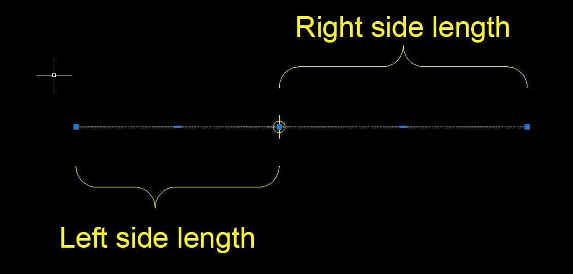

Abdulellah Posted December 11, 2019 Author Share Posted December 11, 2019 I am sorry that I am stressing you, can you program this matter, that I will meet my need سيناريو رسم خط من جهتين.txt Quote Link to comment Share on other sites More sharing options...
