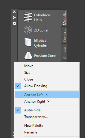

- Is it possible to dock a toolpalletes left of the screen?
Yes, you can dock the command line. Just drag it down to the bottom of the screen until it snaps into place.
Yes, you can dock a tool pallete on the left side of the screen. Right click on the border of the palette and enable "Allow Docking" and then enable "Anchor Left".
