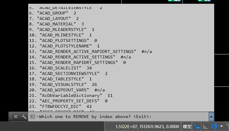

My CAD command log only show very limit lines of prompt log, I can scroll up for earilier lines. Where I can set it to save more log?
You can ON logfile mode to view history of your commands
LOGFILEMODE <1>  = turn on log file
LOGFILEMODE <0>  = turn off log file
If you can't find the log file for the current drawing, you can enter logfilename↵ at the Command prompt and AutoCAD will display the filename, including the full path.
