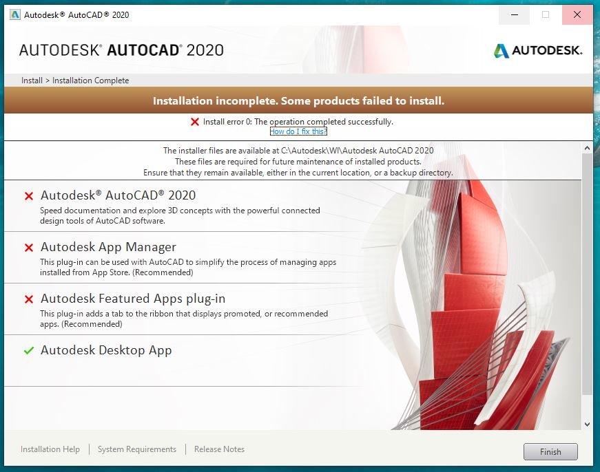

Gali Posted December 1, 2019 Posted December 1, 2019 Hi every one I will be pleased to know why I could install AutoCAD 2020 . I would be more pleased to get help how do that successfully . thank you in advance ! Quote
Cad64 Posted December 1, 2019 Posted December 1, 2019 See here for some possible solutions: https://knowledge.autodesk.com/support/autocad/troubleshooting/caas/sfdcarticles/sfdcarticles/Install-complete-Some-Products-Failed-to-Install.html Also here: https://knowledge.autodesk.com/support/autocad/troubleshooting/caas/sfdcarticles/sfdcarticles/Error-Install-error-1603-Fatal-error-during-installation-when-installing-an-AutoCAD-based-product-version-2020.html Quote
BIGAL Posted December 6, 2019 Posted December 6, 2019 For us it was a .NET version needed the latest version IT builds our PC's and they have a master build. Quote

rkent Posted December 9, 2019 Posted December 9, 2019 Did you get 2020 installed? I recently ran into the same error and tried everything posted above. Finally someone suggested renaming a folder on your computer named C:\Autodesk so I renamed it to C:\Autodeskold and tried again and AutoCAD installed without any trouble. Quote
