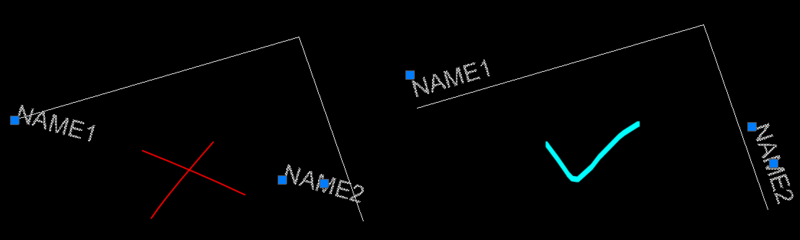

I'm working on a GIS Application which is running with AutoCAD, in that we are placing some lines and structures, while placing that the annotation will be placced automatically middle point of that poly line. after that we need to align that as per the below image. is there any possible to align the blocks automatically. steps would be Select two Blocks--->Select the Line then the blocks should be alined automatically as per the below image.

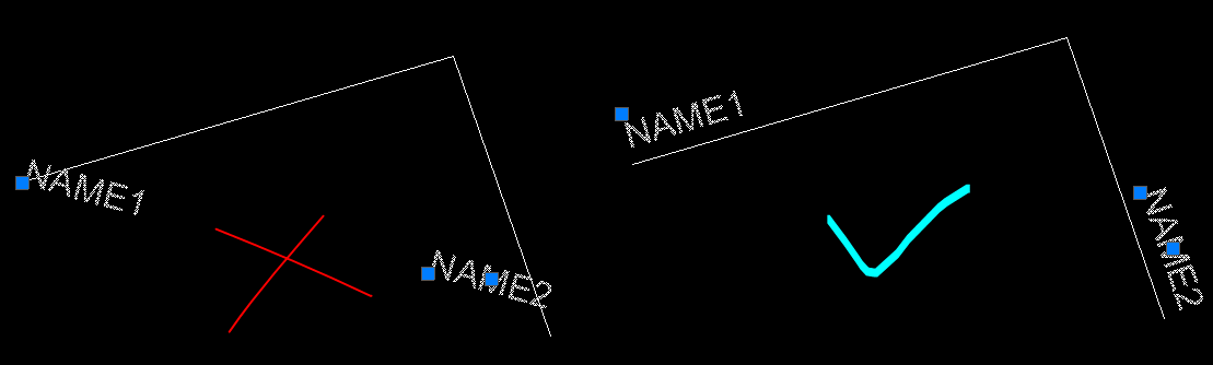

    The first block placed over the line and the second one placed below the line, but i need to place both will be above the line with some spaces between Line and block (As below image)
    also it will work only with straight line, when i tried with bend line the rotation of the block will not changed.can we change the rotation as well.
Note: The Second block justify is Middle, as i said its placed by default in GIS Application, i can't change that justify.

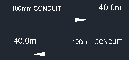

Which block goes where? What happens if a line/polyline is constructed from right to left? Is the layout still the same or does it reflect the line/polyline?
Hi dlanorh,
                   Block1 (100mm conduit) should always appear in starting point of polyline & Block2 (40.0m) should appear in ending point of polyline,(as shown in attached image)
Polylines can be constructed in any way, from left to right / Right to Left, but as mentioned above Block1 should be in starting point & simillarly Block2 should be in ending point of polyline.
& it always reflects the polylines.

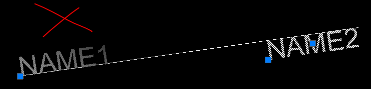

actually both attributes should be different sizes as it is in Actual.dwg, is it possible to align the blocks without changing their heights.
and if the attributes are in 0 degree rotation then only its aligned as per the Polyline rotation angle, or else its aligned to different rotation. can we able to align the blocks to the line rotation if the blocks already placed on any angle.

Try the attached.
The blocks are now rotated to 0.0 before the bounding box is found. This solves the blocks at any rotation problem
To align the blocks the same distance from the line it is neccessary for them to be the same size. The routine now rescales the "LENGTH_ANNO" block back close to its original size, using the new alignment (move) point. Due to the nature of the block and the scales involved this means using a scale factor of 1.333333333, which if you delve into the blocks scale factors with a large precision will not exactly return it to its original size (1.0) but maybe 0.9999999999998.
