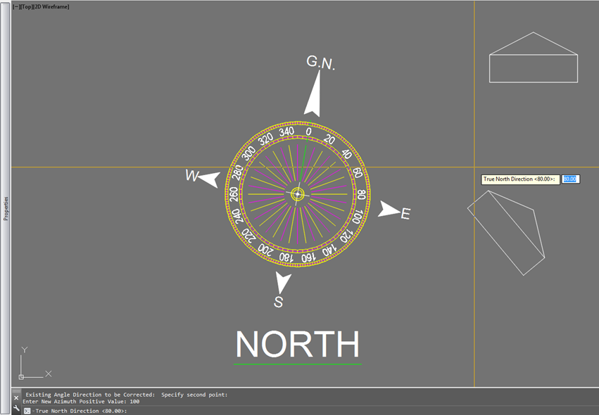

Could someone take a look at this lisp and let me know how I can get true north based on the North Symbol attached to remember my last pick so I can enter values as angle once the true north is set - I am thinking something like Offset command that keeps last entry if it is at all possible. Attached is the north symbol I am using on my projects but to orient antenna blocks to say 40 degrees from true north, then I have to go through selection process instead of value entry each time.
Thanks

I am now having trouble with radian vs. degree. I can get it to show but the calculation is done in radian (I am messed up).

I do not know any other way to have it do what I want.
The code above does show / remembers the true north but I have to re-enter the value again (even though it show it for me), otherwise returns nil.
for some strange reason I have to re-enter the correct value that I succeeded in displaying.

I wanted it to remember my last selection - it has nothing to do with how and many ways I am getting it.
I already solved the problem - it is now gets and remembers the last angle with
(vlax-ldata-get "x" "y")))
(vlax-ldata-put "x" "y" 0.0))

Your indicated North Point shows Grid North and part of your initial question was
  Quote
Expand
That is not possible unless you know
1. How your current drawing is aligned
2. What the actual angular variations are between Grid, Magnetic and True North at the location in the drawing, as this varies depending on it's latitude and longitude. Since you have a North  Arrow indicating Grid North it is simple to calculate the direction of True North.
