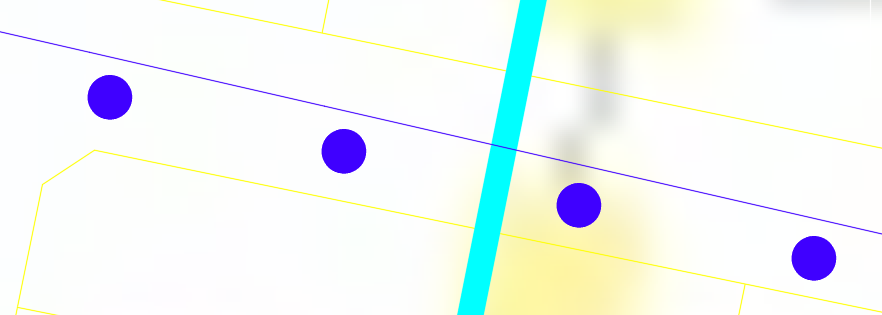

ALLI Posted November 18, 2019 Posted November 18, 2019 I am trying to make a linetype that just has large dots along it, but what I am getting is the dots which are perfect but a line too, Any thoughts? *BIGDOT, O O O O O O A,0,0.0001,["l",WINGDINGS,S=.5,R=0.0,X=0.0,Y=-0.55],2 Quote
BIGAL Posted November 19, 2019 Posted November 19, 2019 (edited) I think its to do with using a -ve vaue for the length of the line *BIGDOT, O O O O O O A,0,-1,["l",WINGDINGS,S=.5,R=0.0,X=0.0,Y=-0.55],-1 try A,0,-5 A,0,-10 etc for spacing Edited November 19, 2019 by BIGAL Quote
ALLI Posted November 19, 2019 Author Posted November 19, 2019 it still has the line above the dots, I am not sure what I am doing wrong. Quote
BIGAL Posted November 19, 2019 Posted November 19, 2019 Did you reload in your dwg and regen they do not auto update when you change the lin file and in fact can have different versions for same name an accident I found. Quote
ALLI Posted November 19, 2019 Author Posted November 19, 2019 Quote Expand Fixed it, I needed to close the drawing for the linetype to reload. Thanks heaps Quote

tombu Posted November 21, 2019 Posted November 21, 2019 As Arial is a Text Style in all my templates I have Large Dot and Arrow linetypes defined in Arial.lin to avoid having to add a Wingdings Text Style I wouldn't use for anything else. *STriangle, Solid Triangle__/_\_/_\__/_\_/_\_/_\_ S,.000000001,-.05,["\U+25BA",Arial,S=0.02,R=90,Y=-.0019],-.05 *ARROWH,Arrowhead > > > > > > > A,.000001,-3,["\U+25BA",Arial,S=3,R=0,X=-1.35,Y=-1.35],.000001,-4 *ArialARROW,Arrow1 > > > > > > > S,.000001,-3,["\U+25AC",Arial,S=3,R=0,X=-1.35,Y=-1.05],.000001,["\U+25BA",Arial,S=3,R=0,X=0.5,Y=-1.42],.000001,-4 *ArialDOT,Dot . . . . . . . . . . . . . . . . . . . . . . . . A,0,-.125,["\U+2022",Arial,S=.05,Y=-.024],-.125 *ArialDOT2,Dot (.5x) ........................................ A,0,-.0625,["\U+2022",Arial,S=.05,Y=-.012],-.0625 *ArialDOTX2,Dot (2x) . . . . . . . . . . . . . . A,0,-.25,["\U+2022",Arial,S=.05,Y=-.048],-.25 Putting Text Style dependant linetypes in Acad.lin will display an error when trying to load a linetype if that Text Style isn't in the drawing. Keeping all lin files in the roamable support folder (where acad.lin is already) allows them to be listed when you click the [File…] button to the left of acad.lin makes loading from different lin files easier. Macro example to open Arial.lin: ^C^C_start;Arial.lin; One of many good reasons to use Text Styles named to describe the font they use. Of course I will load a Wingdings Text Style sometimes as there's no other way to add a DANGER linetype like: *Danger, --- DANGER --- DANGER ---- A,.3,["N",WINGDINGS,S=.05,Y=-.025],-.05,["DANGER",Swiss Light,S=.05,Y=-.025],-.29,["N",WINGDINGS,S=.05,Y=-.025],-.05,.1 1 Quote
