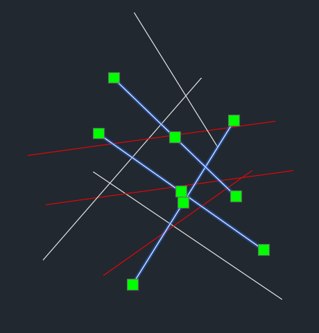

j_spawn_h Posted November 13, 2019 Posted November 13, 2019 I was looking for a way to change a line type or any thing on the line by just swiping all the lines. Lets say you have 3 lines. line 1 is on a layer L1 line 2 is on layer L2 line 3 is on layer L10 both 1&2 touch line 3 some where some how. i would like to select all three and if 1 & 2 touch 3 change the layer of 3 to L3. Quote
Jonathan Handojo Posted November 14, 2019 Posted November 14, 2019 Well, how would you select all three? Would you entsel line1 and line2 and check for a line that touches both? Or entsel line3 and check for corresponding lines that touches line3? There needs to be a criterion to it. Quote
j_spawn_h Posted November 14, 2019 Author Posted November 14, 2019 i am hoping just to select all of them with a window. I mainly wondering can the point where they all touch be recognized and can distinguished between the three, so i can use some type of if statement. Like if 1 & 2 touch 3 then do this to 3. Quote

BIGAL Posted April 15, 2020 Posted April 15, 2020 Ronjonp fastsel its cool ! SSget "F" pick purple line will find all others lines that cross or touch just an idea. Quote
j_spawn_h Posted April 17, 2020 Author Posted April 17, 2020 Fastsel selects the items now how do extract the info to use. I would like to say something like if line 1 with named layer 1 an line 2 named layer 2 if they are touching line 3 change the layer on line 3 from 3 to 4. I see what Jonathan has above but for the life of me i can not make it do what i need. I am sure its just me not knowing enough lisp or VLA. Quote
Jonathan Handojo Posted April 17, 2020 Posted April 17, 2020 (edited) Maybe this will do it for you then: The LISP routine will select lines from the first selection set intersecting all lines from the second selection set. (defun c:ltouch ( / *error* adoc alllst i iter rtn ss ssall sstouch touchlst) (defun *error* (msg) (vla-EndUndoMark adoc) (princ (strcat "Error: " msg)) ) (setq adoc (vla-get-ActiveDocument (vlax-get-acad-object))) (vla-StartUndoMark adoc) ;; Start routine (setq ssall (ssget "_X" '((0 . "LINE,LWPOLYLINE"))) ;ssall (progn (princ "\nSelect all lines to process") (ssget '((0 . "LINE,LWPOLYLINE")))) ; Uncomment above line and comment (or delete) the first line to select the lines to calculate. ; Makes it faster to calculate only a few lines instead of every line in the drawing. sstouch (progn (princ "\nSelect lines to touch") (ssget '((0 . "LINE,LWPOLYLINE")))) ) (if (and ssall sstouch) (progn (repeat (setq i (sslength sstouch)) (ssdel (ssname sstouch (setq i (1- i))) ssall) ) (setq alllst (JH:selset-to-list-vla ssall) touchlst (JH:selset-to-list-vla sstouch) rtn (mapcar 'vlax-vla-object->ename (vl-remove-if-not '(lambda (x) (vl-every '(lambda (y) (vlax-invoke y 'IntersectWith x acExtendNone) ) touchlst ) ) alllst ) ) ) (sssetfirst nil ((lambda (x / ss) (setq ss (ssadd)) (mapcar '(lambda (y) (setq ss (ssadd y ss))) x) ss) rtn)) ) ) ;; End routine (vla-EndUndoMark adoc) (princ) ) (defun JH:selset-to-list-vla (ss / i rtn) (if ss (repeat (setq i (sslength ss)) (setq rtn (cons (vlax-ename->vla-object (ssname ss (setq i (1- i)))) rtn)) ) ) rtn ) Above is an example: First selection set: All lines Second selection set: Red lines Returns: Selection in the above picture. In your case, if you select line 1 and line 2, line 3 will be selected. Or if you select just line 3, line 1 and 2 will be selected. Edited April 18, 2020 by Jonathan Handojo JH:selset-to-list-vla modified Quote

j_spawn_h Posted April 20, 2020 Author Posted April 20, 2020 On 4/17/2020 at 11:18 PM, ronjonp said: (defun JH:selset-to-list-vla (ss / rtn) (if ss (repeat (setq i (sslength ss)) (setq rtn (cons (vlax-ename->vla-object (ssname ss (setq i (1- i)))) rtn)) ) ) (reverse rtn) ) On 4/18/2020 at 1:47 AM, Jonathan Handojo said: e back Thanks for your help. I see how this leave the 3rd line last but, now i can not figure out which variable is the correct one to use. I want to change the 3rd line layer properties. I have tried using select, then last, the change I tried every variable and it does not grab it. if you do not mind helping me out. Ill keep trying different things until then. Thanks again the help all ready. I am one step closer. Quote
Jonathan Handojo Posted April 20, 2020 Posted April 20, 2020 3 hours ago, j_spawn_h said: Thanks for your help. I see how this leave the 3rd line last but, now i can not figure out which variable is the correct one to use. I want to change the 3rd line layer properties. I have tried using select, then last, the change I tried every variable and it does not grab it. if you do not mind helping me out. Ill keep trying different things until then. Thanks again the help all ready. I am one step closer. The routine above only selects the line, that's all. I don't really understand how your layer-changing criteria works. You simply keep saying "If line 1 is on L1, and line 2 is on L2, and line 3 somehow touches both lines, change to L3". What if "line 1 is on layer L4 and line 2 is on layer L1" or "line 1 is on layer L2 and line 2 is on layer L6"? Then where's line 3 changing to? Quote
j_spawn_h Posted April 20, 2020 Author Posted April 20, 2020 With your routine it leaves the last line highlighted. How can i do any changes to that line with the more lisp routine. Maybe this will make more since. I posted what i was trying to do to your code. Key word trying... lol (defun c:ltouch ( / *error* );adoc alllst i iter rtn ss ssall sstouch touchlst) (defun *error* (msg) (vla-EndUndoMark adoc) (princ (strcat "Error: " msg)) ) (setq adoc (vla-get-ActiveDocument (vlax-get-acad-object))) (vla-StartUndoMark adoc) ;; Start routine (setq ssall (ssget "_X" '((0 . "LINE,LWPOLYLINE"))) ;ssall (progn (princ "\nSelect all lines to process") (ssget '((0 . "LINE,LWPOLYLINE")))) ; Uncomment above line and comment (or delete) the first line to select the lines to calculate. ; Makes it faster to calculate only a few lines instead of every line in the drawing. sstouch (progn (princ "\nSelect lines to touch") (ssget '((0 . "LINE,LWPOLYLINE")))) ) ; (8 . "S-FRM-ROOF,S-FRM-16RFTR,S-FRM-15RFTR,S-FRM-14RFTR,S-FRM-13RFTR,S-FRM-12RFTR,S-FRM-11RFTR,S-FRM-10RFTR,S-FRM-9RFTR,S-FRM-8RFTR,S-FRM-7RFTR,S-FRM-6RFTR,S-FRM-5RFTR,S-FRM-4RFTR,S-FRM-3RFTR,S-FRM-2RFTR,S-FRM-RDG")) (setq en (ssname sstouch 0)) (setq ed (entget en)) ;(setq lyr (cdr (assoc 8 ed))) (if (= lyr "S-FRM-8RFTR")(setq ly2 8)) (if (= lyr "S-FRM-16RFTR")(setq ly3 16)) (if (and (= ly2 8)(= ly3 16))(setq lyr4 "S-FRM-8ROOF")) (setq ln (if (and ssall sstouch) (progn (repeat (setq i (sslength sstouch)) (ssdel (ssname sstouch (setq i (1- i))) ssall) ) (setq alllst (JH:selset-to-list-vla ssall) touchlst (JH:selset-to-list-vla sstouch) rtn (mapcar 'vlax-vla-object->ename (vl-remove-if-not '(lambda (x) (vl-every '(lambda (y) (vlax-invoke y 'IntersectWith x acExtendNone) ) touchlst ) ) alllst ) ) ) (sssetfirst nil ((lambda (x / ss) (setq ss (ssadd)) (mapcar '(lambda (y) (setq ss (ssadd y ss))) x) ss) rtn)) ) )) ;; End routine ;(defun jh:highlightselsel ( / selset) ;(setq selset (ssget)) ;(sssetfirst nil selset) ;) (command "change" "" "" "p" "la" lyr4 "") ;(setq lle (entlast)) (vla-EndUndoMark adoc) ; (vlax-vla-object->ename obj) (princ) ) (defun JH:selset-to-list-vla (ss / rtn) (if ss (repeat (setq i (sslength ss)) (setq rtn (cons (vlax-ename->vla-object (ssname ss (setq i (1- i)))) rtn)) ) ) (reverse rtn) ) Quote
Jonathan Handojo Posted April 22, 2020 Posted April 22, 2020 Hopefully this explanation is more clear. I don't know how you want to change your layers so I'll leave that to you. (defun c:ltouch ( / *error* adoc alllst i iter rtn ss ssall sstouch touchlst) (defun *error* (msg) (vla-EndUndoMark adoc) (princ (strcat "Error: " msg)) ) (setq adoc (vla-get-ActiveDocument (vlax-get-acad-object))) (vla-StartUndoMark adoc) ;; Start routine (setq ssall (ssget "_X" '((0 . "LINE,LWPOLYLINE"))) ;ssall (progn (princ "\nSelect all lines to process") (ssget '((0 . "LINE,LWPOLYLINE")))) ; Uncomment above line and comment (or delete) the first line to select the lines to calculate. ; Makes it faster to calculate only a few lines instead of every line. sstouch (progn (princ "\nSelect lines to touch") (ssget '((0 . "LINE,LWPOLYLINE")))) ) (if (and ssall sstouch) (progn (repeat (setq i (sslength sstouch)) (ssdel (ssname sstouch (setq i (1- i))) ssall) ) (setq alllst (JH:selset-to-list-vla ssall) touchlst (JH:selset-to-list-vla sstouch) rtn (mapcar 'vlax-vla-object->ename ; <--- Returns the list of lines that satisfies the desired criteria (vl-remove-if-not '(lambda (x) (vl-every '(lambda (y) (vlax-invoke y 'IntersectWith x acExtendNone) ) touchlst ) ) alllst ) ) ) ; rtn is a LIST of entities that matches the described criteria. (setq rtnsel ; <--- This line converts that list to a selection set that you can use with (command) afterwards ((lambda (x / ss) (setq ss (ssadd)) (mapcar '(lambda (y) (setq ss (ssadd y ss))) x) ss ) rtn ) ) ; Resume your commands here ; Don't add anything below this line. ; (sssetfirst nil rtnsel) ; This one does a full selection of that set in the AutoCAD screen ) ) ;; End routine (vla-EndUndoMark adoc) (princ) ) (defun JH:selset-to-list-vla (ss / i rtn) (if ss (repeat (setq i (sslength ss)) (setq rtn (cons (vlax-ename->vla-object (ssname ss (setq i (1- i)))) rtn)) ) ) rtn ) Quote
