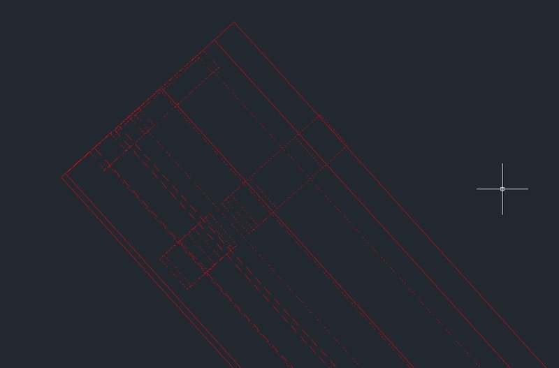

We often get drawings drawn using MicroStation and then exported to DWG and we have hundreds of blocks within the drawing that have slightly different block names, albeit they are the same block.
Block Name: "Smart Solid_386"       (The number on the end '386' changes).
There are hundreds of these blocks within our drawings and I what a way of selecting all of them and deleting.
I can’t seem to find a way of using ‘Quick Select’ to do it and not sure exactly how ‘Filter’ could be used?
Probably an easy question for somebody, as I’m sure it’s come up before but I can’t seem to find the answer.
Any help would be great.

I have attached a sample drawing for you try your script on and also to try the Filter option. Also if you look at the CT.jpg screenshot attached, i have selected the block i want to be removed. Its the block that sits in the middle of the main light block although i think they share a similar name! However the block i want to be removed has another block inside that with a different name, maybe we could use this block name to remove them?

Copy and Paste the code to the command line and enter to display all those blocks selected.  Using a saved filter should work as well, but the selection set will not display selected.  Just start ERASE and Enter L (Last) at the "Select objects:" prompt, then Enter again.

QSELECT>Block Reference>Name>*Wildcard Match>Smart Solid*

This is brilliant way but i can’t fill value space. And i can’t see ‘smart solid’
Do you have a block named "Smart Solid"?
Can you post the  .dwg?
I have tried one more time and it works. Thank you so much.
I have forgotten /*/ to write.
