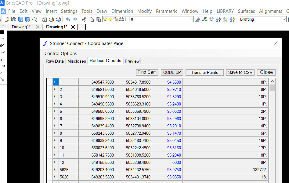

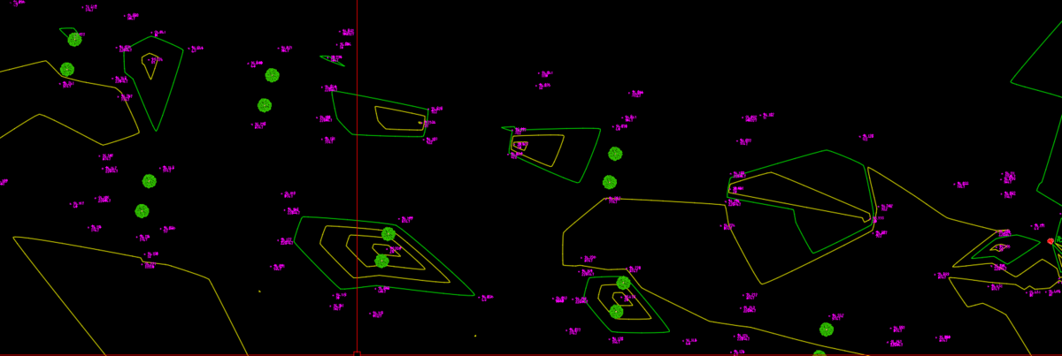

Ok my take no code around 2 mins.
Open file in excel
sort all data on column A
cut stns and pastes into code column instead
add numbers 1-21 where stn name was
save csv
use CIV3D PENZD create point group it has a label style preset.
make surface display contours,  all done see image. Change label style as required.

Why not Briscad and Civil Site design then contour.
Forgot to mention if the code is field survey strings then after setting up library the plan would have been strung and line work produced for both Briscad and CIV3D.
Edited by BIGAL
the thing is Bigal, I am manually connecting lines cause we don't have line coding, and inserting them in proper layers and so on...we only have coding for street infrastructure and
I made lisp for inserting blocks on those points...so you see why I need all that numbers visible and can't do it through Civil
