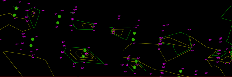

Yes, the format is right and now I attached input file.
I need 2d and 3d because I use them intermittently.
When u run it through lisp you get result after 15sec.

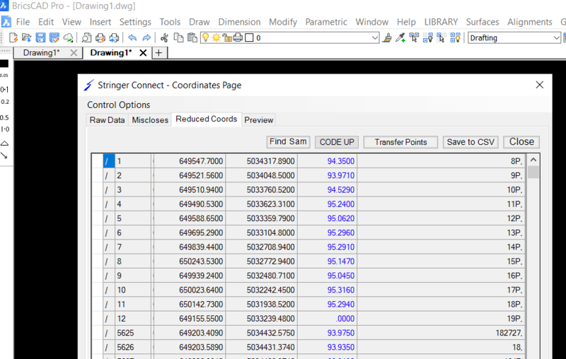

I need to know how this looks when you import the file into autocad eg a sample drawing of an imported point saved in autoCAD 2010 format.
Like dlanorh #metoo have a little bit difficulty understanding how to interpret your data file. If i'm correct your have 2 flavors :
19P,649155.550,5033239.480,0.000,,
5625,649203.409,5034432.575,93.975,182727,
first line is item with a name (19P) + x y z + ,
second line is ? + x y z + ?
so first type actually contains 4 items (19P 649155.550 5033239.480 0.000)
and second line contains 5 items         :  (5625 649203.409 5034432.575 93.975 182727)

I'm assuming the lines with 4 items are actually survey stations (stn id,  coord list) and the lines with five items are surveyed points (pt number, coords list, point code), but without knowing the final format optimising the final format is problematic.
the format is:  point number/name,y,x,z,code,note (sometimes there's no code and most of time there's no note that's why it's ,, on the end)
and I included dwg
