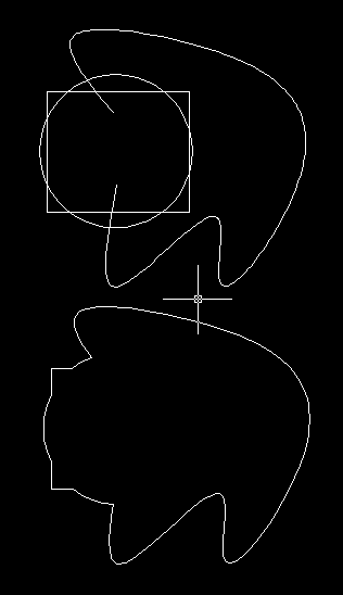

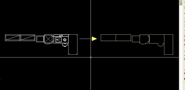

Is there any way to extract or trace a blocks contour ?
I want a fast solution so i don't have to draw tha contour manualy.
I attach a image to ilustrate my request.
I use AutoCAD 2002.
This lisp program draw contour of selected objects. Type ECO to run. Written by VVA.

An other way: draw a rectangle around the block and use BPOLY. Click a point between the block and the rectangle. AutoCAD will create two polylines: the desired one and one other in the top of the rectangle. Delete the two rectangles and move the contour in the desired place:
Command: MOVE
Select objects: l
1 found
Select objects:
Specify base point or [Displacement] : ....
Thank you for your help.It looks exactly what i need.
Anyway, i can't seem to get it to work.
How exactly do i load and run this script ?
I managed to get it to work.
Thank you very much for the help.

The script runs fine but i discovered a little glitch.
When i have a block which was scaled up or down (on any direction x, y or z)
the script cannot draw the contour.
In other cases, even though the block is not scaled i have to explode it a few times until the script can draw the contour.
Is there a solution for this ?

There is a more advanced tool - TotalBoundary. Look at this:
Direct download from this link.
