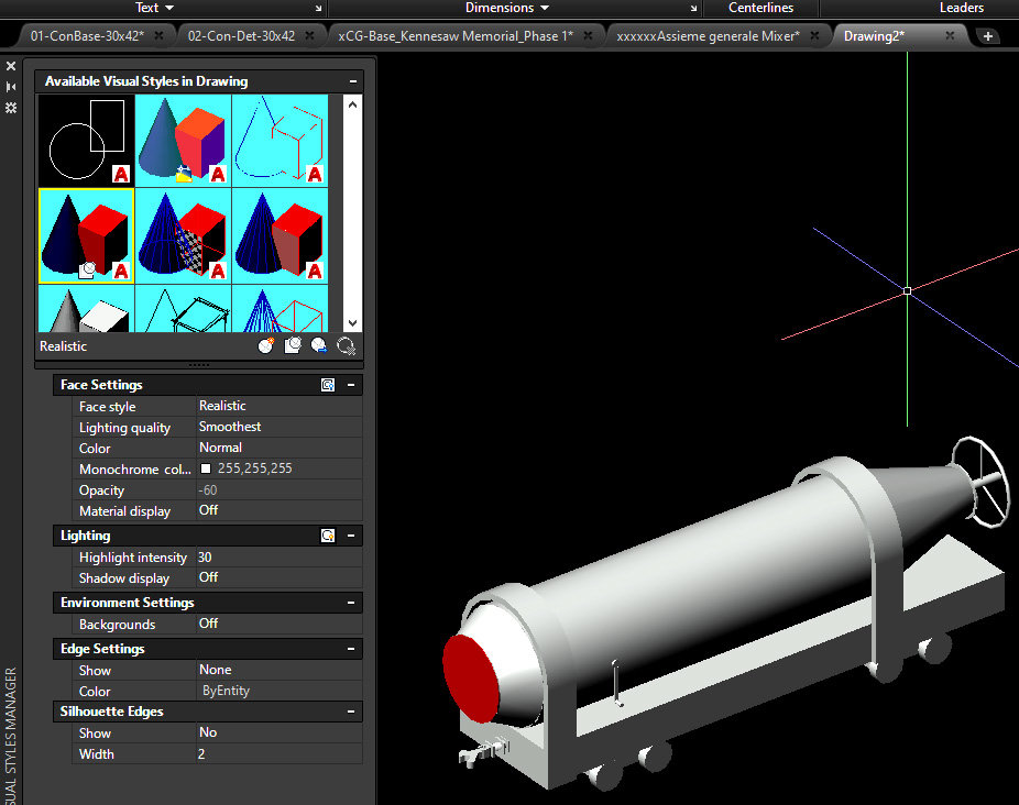

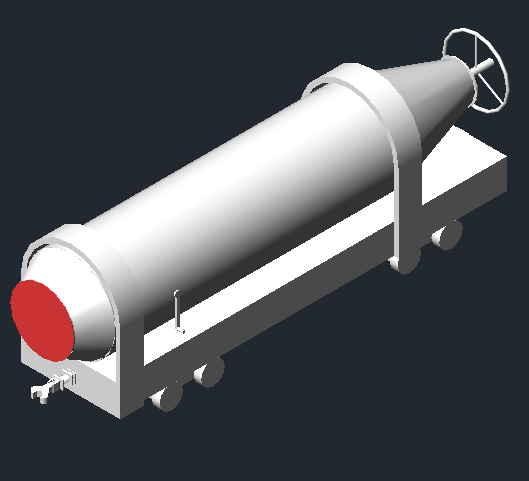

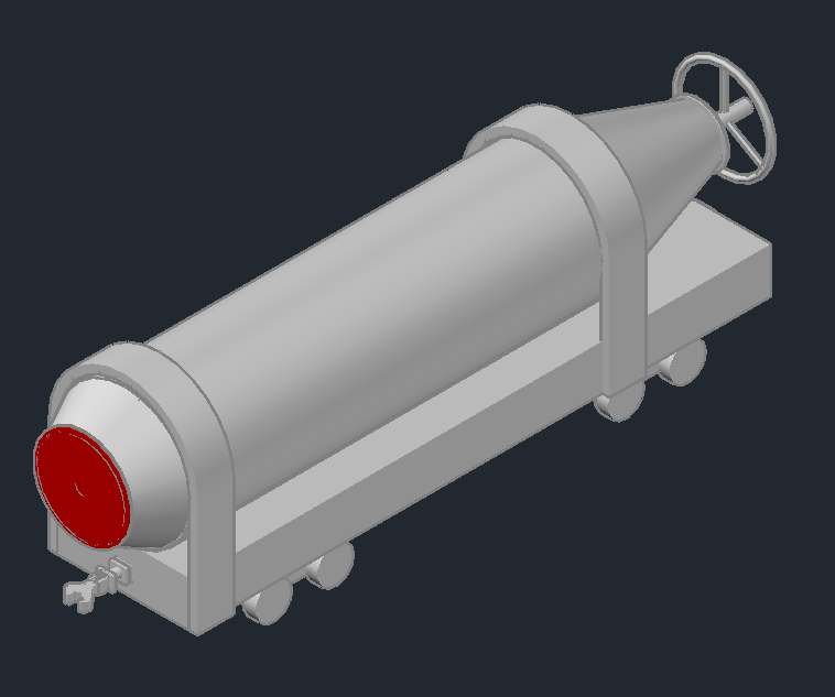

One of your files has Shademode set to Conceptual. The other file has Shademode set to Realistic. That's why they look different.
I check and try to set together realistic can you try ?
The light and shadows seem differents
Edited by jim78b

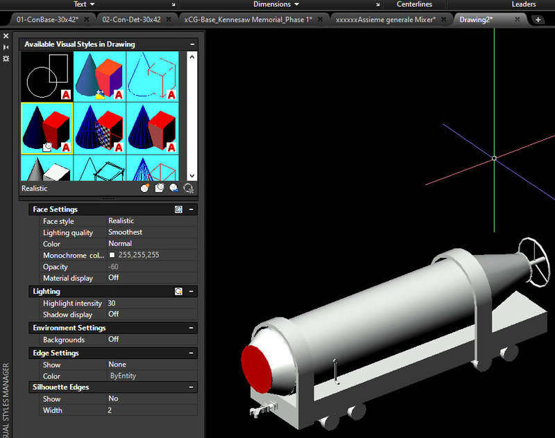

I compared the "Realistic" settings in both files and one is different from the other. You will need to adjust your VISUALSTYLES settings for "Realistic" to the settings shown below.
