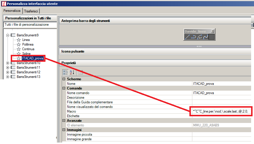

This is the logo that identifies the alternative CAD we use is based on the 2018 autocad ...
unfortunately for these types of CAD it is not possible to use lisp I am sure of that...
When I joined the forum I could use autocad full 2018 (about my profile)...then to save in the company it was decided to change program.
I was wrong instead of using "macros"...that I don't know what they are but that I managed to make it work in the following way (I created a command):

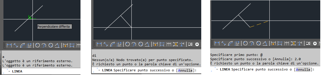

when I tried it however I didn't get the result shown by SEANT ... in the following image the sequence of operations in the use of the program.
it seems to me to do the same thing as the proposed movie but the line does not bypass the bisector.

*^C^C_line;per;\nod;\;_scale;_last;;@;2.0;
The asterisk (*) in front of the macro should keep repeating the command sequence, ultimately requiring a tap on the Escape key (Esc on English keyboards)

If true, that called for one more look at the sequence of screen captures in Post # 20.  Now, I think I have it right:
*^C^C_line;_per;\_nod;\;_scale;_last;;@;2.0;
Every word needs underscore.

I tried the command after you corrected it, now the extension after the "bisector" works, but there is a problem that I will now describe to you:
1) The command starts by establishing which line to use as a bisector (the perpendicular snap appears)
2) The next step is to direct the line that is created in one direction
3) in the next step there is a drawback I show you: the command works if I choose a random point, but if I try to choose an object snap point, I don't get an extended line after the bisector

In your original post you showed a drawing with points, that is what the '_nod' part of the script looks for (and only 'nodes') if you wish to pick other snaps so as 'cen' or 'end' etc then just remove the '_nod' but you will then need to make sure that you have the required snaps selected in the 'dsettings' dialogue 'object-snap' tab and that you have object snaps turned on.
