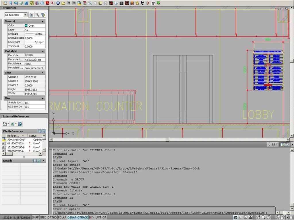

heres the command line screenie, , even if i set the CMDDIA and FILEDIA variables to 1 , still it insists the command at the cmd line
please help, , i dont know how to deal with this now

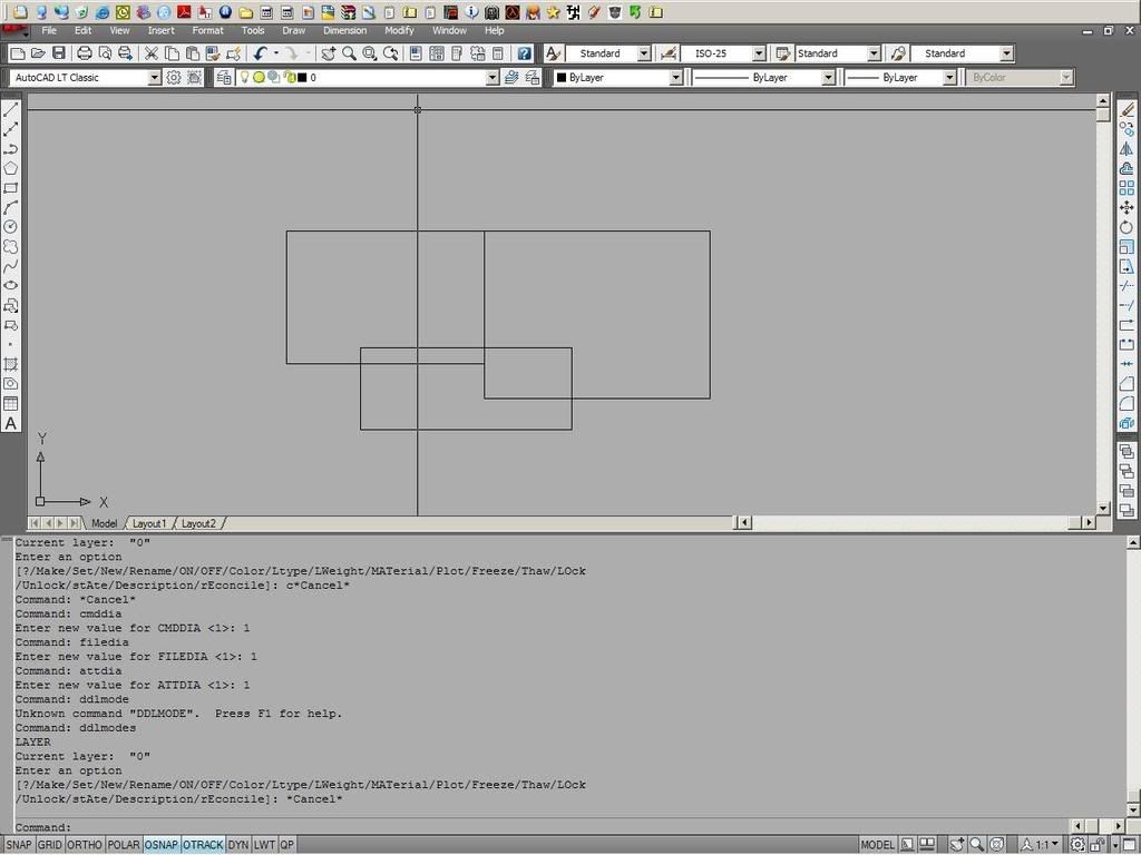

heres what happened when i key in that ddlmodes, , still the problem occurs. . huhuhu, , im having enough of this dialog box. . any other way ?
