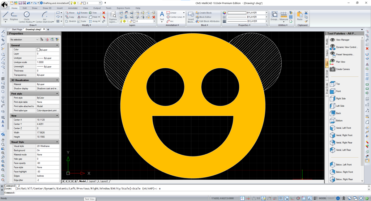

CMS IntelliCAD CAD Software is free for education as AutoCAD is.
Pretty useful for my school work because it allowed me to develop CAD LISP routines that I needed to program.
They also provide a pretty cool method for running their software, and I can run it anywhere. I've applied for a free license at their website and got it by email.
Happy Days!
Edited by Juan Sevilla
image was not mine, replaced with one that I created :)))
