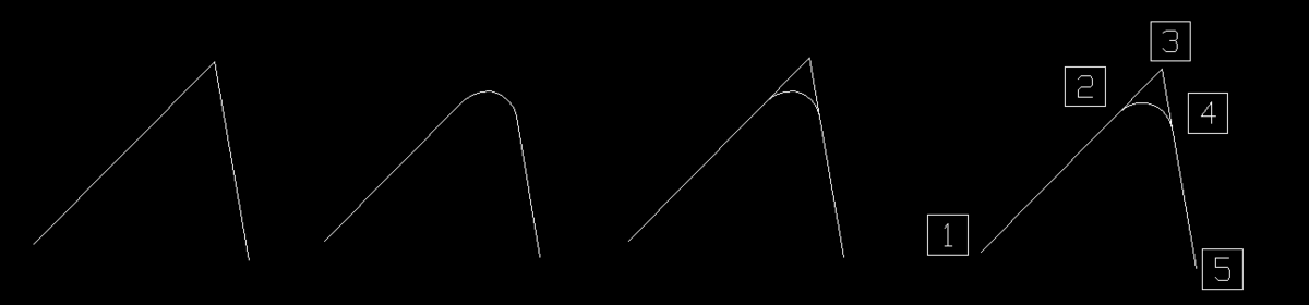

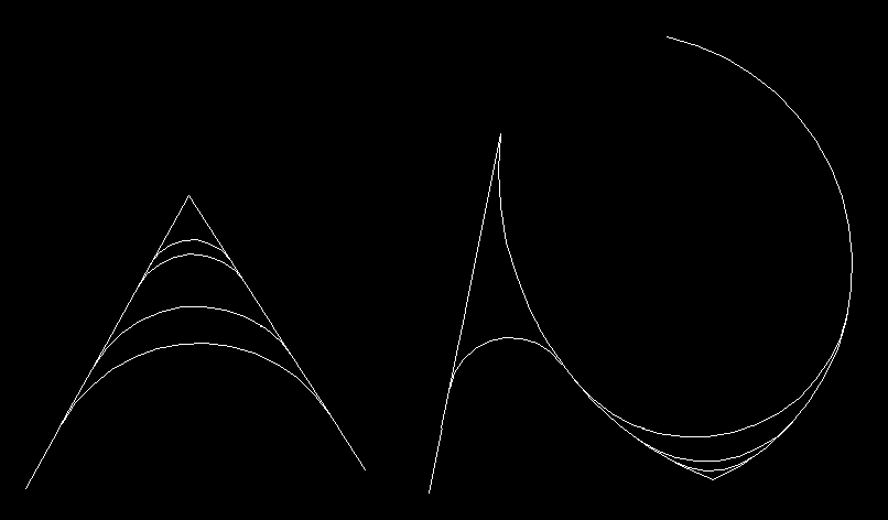

Part of my company's drawing standards are to make sure that all internal included corners of a profile are radius-ed.  I am trying to avoid using any commands in my code and keep everything in VLA(X).  My current logic for creating the fillets works fine for 2 of the 3 scenarios that I run into.  I may be over complicating things, but I assume I need to calculate the point that the arc will make with my geometry.

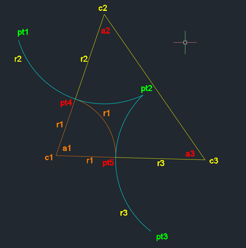

In the images; CYAN is the original geometry, GREEN & ORANGE are known, YELLOW can be calculated from the knowns, and RED is what I need to ascertain.
Figure 1: Simply trig out d4 and use polar to find pt4 (same for d5 and pt5).
Figure 2: Law of Cosines SAS to get a3 angle, polar the distance r3 to get pt5.
Figure 3: HTF do I solve this?!?!
I have been racking my brain for a week trying to find a solution.
Any and all help is appreciated.

You are missing some calculable geometry in 3. The long chord (LC) pt2->pt3 is easy to calculate and LC/2 and r can be used to calculate the bulge factor for a given curve. Negative bulge factors denote clockwise curves and positive for ccw curves.
Don't overlook using (vla-offset) or drawing other geometry (circles, xlines and rays) using their vla-add methods and using (vla-intersectwith) or the (vlax-invoke obj1 'intersectwith obj2 acextendnone) to get straight coords. All the add methods return the object created, so can be assigned variables and then deleted.
A hint for 3 (assuming an arc).  pt5 will lie on a line joining the centre points of  the required arc (orange) and the arc described by pt2 pt5 pt3

As you are drawing an arc from pt2 to pt3 , I assume you know it's Radius "R" and it's Center "C" (the center of the circumference).
As the center of this circumference, the center of the circumference tangent to it and the point of tangence (pt5) are on the same line, it is very easy to find pt5, at a distance R from C.
The point pt4 is the perpendicular to line  pt1-pt2 from a1, which can be found via:

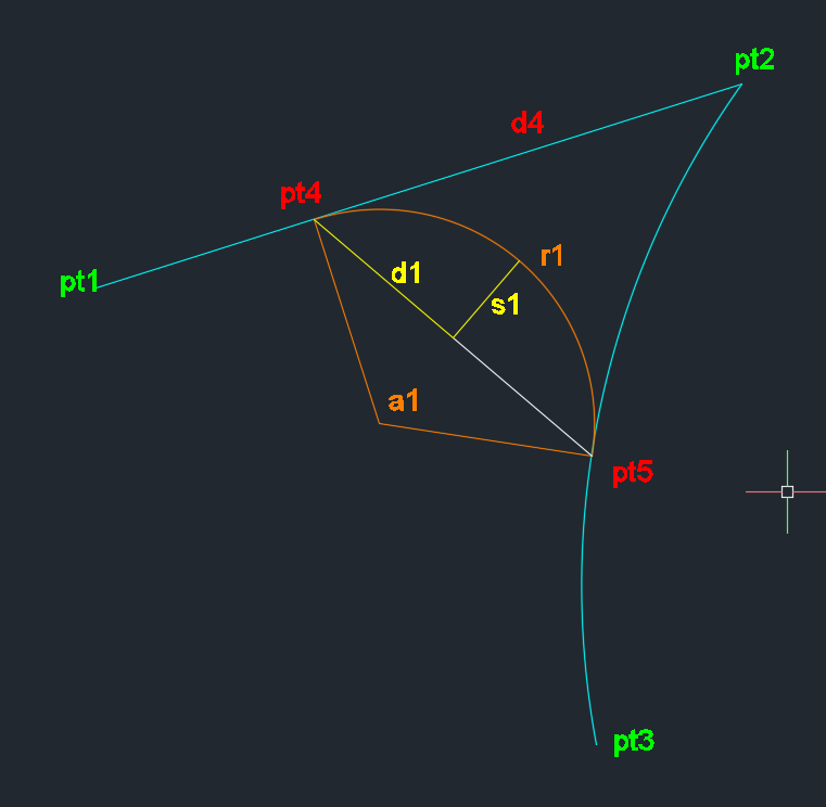

vla-addarc still requires that I calculate the 3 unknowns of the orange arc.
Honestly, I don't think a drawing will be of any more help.  It's really any random length line with a random arc and adding a radius between them.
I am stoopid.
I just noticed that I didn't specify that the orange arc is what I need to create.  I don't know where the orange arc will exist.  The angle, bulge, and radius are known, but not the location of the center point of the orange arc.  Hence the need for the triangulation.

In figure 3, c1 (not drawn, but the center of your circumference) will be the intersection of a line paralell to pt1-pt2 at a distance of r1 and a circumference with center in C and radius R+r1.
So it's not difficult to locate c1 with vlax.
After that,  my last post applies to find the other points and distances.

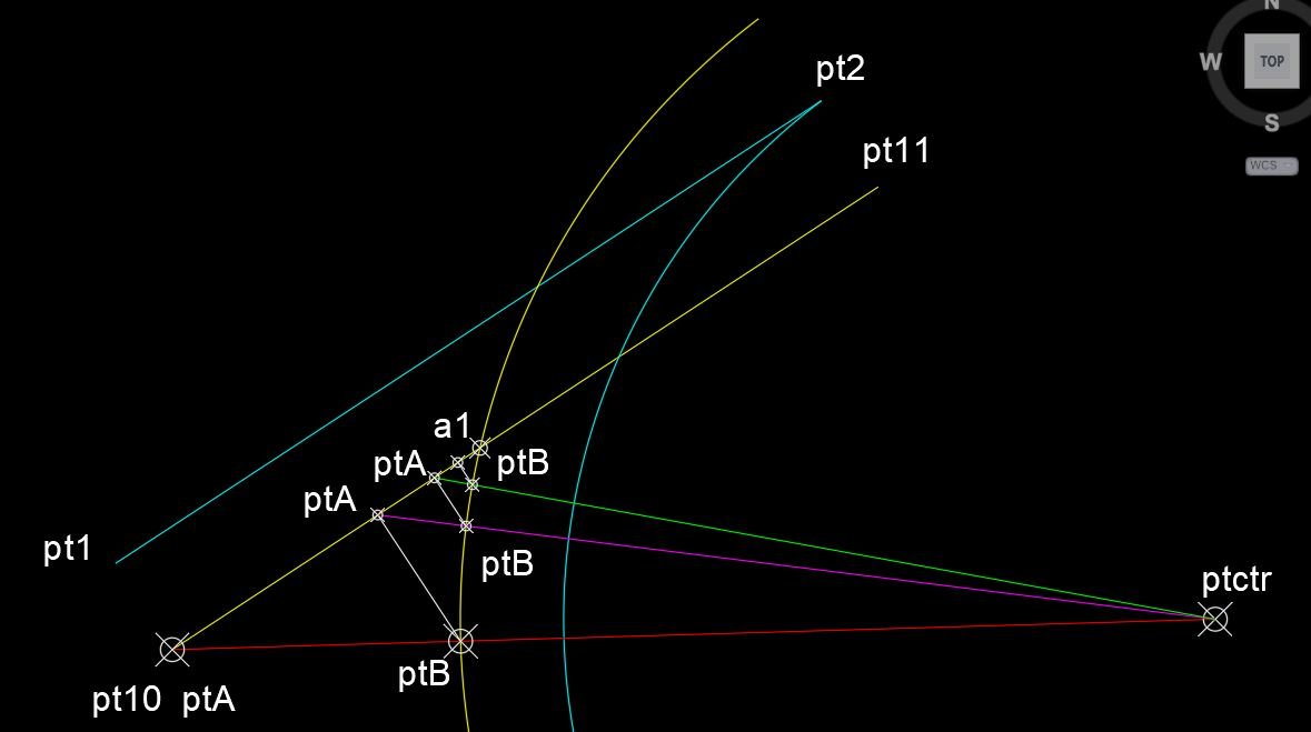

There are two general mathematical approaches for calculating the center of the fillet radius (a1 in your figurer 3).  One is to analytically solve for the intersection of a line and an arc.  In this case the line will be a line offset from line pt1 pt2  by a distance r1 (the radius of the fillet). The center of the fillet will also be on an arc of radius equal to the fillet radius + given arc radius  r = r1 + r2.  This arc will have the same center as the given arc.
Since a line may intersect an arc twice, part of the task is to determine which of the two possible solutions is the one you want.  This can be done with a bias point determined from existing geometry or by the user specifying which solution is needed.

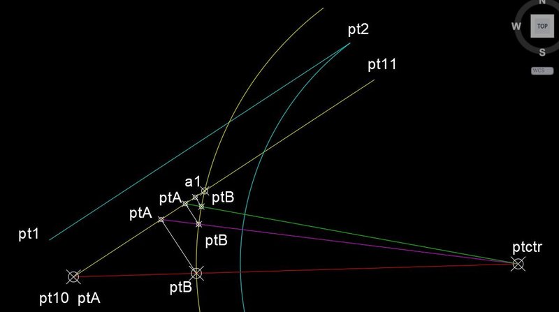

Another method for finding the fillet center is to use numerical methods which use a sequence of systematic guesses to find a solution that is numerically satisfactory. I thought I'd have some fun with this problem and try a numerical solution.
In the code below pt10 and pt 11 define the line offset from the line passing through pt1 pt2 by the distance r1. A unit vector perpendicular to line p1 p2 and pointing towards the arc center (ptctr) is used to determine the direction of the offset.
The end of the offset line is used as an initial guess for the location of the center. This is the left most ptA.
  1. ptB is the intersection of the line from ptA to ptctr.
  2. ptB is then projected to line from pt10 to pt11> This defines a new ptA
Step 1 above is repeated using the new ptA
Step 2 is repeated to calculate a new ptB
The process continues until the distance between the most recent values for ptA and ptB is less than a specified tolerance.  I set this value to 0.00001 in the code below but it could be smaller or a percentage of some value (e.g., the extents).
If a solution is not found in 100 tries the message "No Solution" is displayed.
That does solve my third issue!  Thank you.

I appreciate all the work you put into that program, but my only issue is with solving Figure 3.
After i figured it out , there's a very simple solution could be done without hard coding.
simply use command CIRCLE (Tan Tan Radius) then TRIM the residual
i'm not sure this is how you do it manually Figure 3?

On 10/30/2019 at 10:19 PM, sublimation said:
I already do it by hand.  The boring/tedious part is doing it 400+ times in each drawing.  It eats up an entire day.
Without actual drawing, this is what i imagine you are doing Figure 2 ?
we don't understand whether you wanna label it or draw something export something else etc.. that's why @BIGAL was asking you sample drawing which he means was with automation maybe just few seconds to solve 400+  :)
On 10/30/2019 at 10:17 PM, sublimation said:
I would certainly rather create and delete geometry than do it by hand.  I just figured that there has to be a way to do it mathematically.
yes by law of cosines
  (defun acos (x /)
    (cond ((equal x 1.0 1.0e-16) 0.0)
          ((equal x -1.0 1.0e-16) pi)
          ((< (abs x) 1.0) (- (* pi 0.5) (atan (/ x (sqrt (- 1.0 (* x x)))))))
          (T nil)
    (defun cosine (a b c / sq)
    (setq sq '((x) (* x x)))
    (acos (/ (- (+ (sq a) (sq b)) (sq c)) (* 2.0 a b)))
example:
(cosine 3 4 5);1.5708
(cosine 4 5 3);0.643501
(cosine 5 3 4);0.927295
However since your task is solved, good luck ;)
