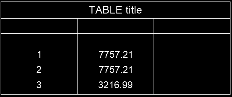

; area using bpoly based on text inside a closed object circle ok.
; By Alan H Oct 2019
(defun AH:table_make (numcolumns txtsz / numrows curspc colwidth numcolumns numrows rowheight sp doc)
(vl-load-com)
(setq sp (vlax-3d-point (getpoint "Pick top left"))); or use getpoint
(setq doc  (vla-get-activedocument (vlax-get-acad-object) ))
(if (= (vla-get-activespace doc) 0)
(setq  curspc (vla-get-paperspace doc))
(setq curspc (vla-get-modelspace doc))
(setq numrows 2)
(setq rowheight (* 2.0 txtsz))
(setq colwidth 50)
(setq tobj (vla-addtable curspc sp numrows numcolumns rowheight colwidth))
(vla-settext tobj 0 0 "TABLE title")
(vla-SetTextHeight tObj (+ acDataRow acTitleRow acHeaderRow) txtsz)
(defun c:ahobjarea ( / ins txt obj2 objid lay x lst ent area ss)
(setq obj (vlax-ename->vla-object (car (entsel "pick text"))))
(setq lay (vla-get-layer obj))
(princ "\nPick all text")
(setq ss (ssget (list (cons 0 "text")(cons 8 lay))))
(setq lst '())
(repeat (setq x (sslength ss))
(setq ent (entget (ssname ss (setq x (- x 1)))))
(setq ins (cdr (assoc 10 ent)))
(setq txt (atoi (cdr (assoc 1 ent))))
(setq lst (cons (list txt ins ) lst))
(setq lst (vl-sort lst
'(lambda (x y) (< (car x)(car y)))
(AH:table_make 3 5)
(setq x -1)
(repeat  (length lst)
(setq ent (nth (setq x (+ x 1)) lst ))
(setq objid  (rtos (car ent  ) 2 0))
(setq ins (cadr ent))
(command "bpoly" ins "")
(setq obj2 (vlax-ename->vla-object (entlast)))
(setq area (rtos (vla-get-area obj2) 2 2))
(command "erase" (entlast) "")
(setq rownum (vla-get-rows tobj))
(vla-InsertRows tobj  rownum  (vla-GetRowHeight tobj (- rownum 1)) 1)
(vla-settext tobj rownum  0  objid)
(vla-settext tobj rownum  1 area)
(c:ahobjarea)

Mr. Bigal, i.e.
I tried the lispi you sent. It works well. But it's not what I want it to be. I want the pose numbers in the table to be printed with lisp on polyline.
Understand its a different method that can be used in Emmanuels code. Yes it needs the table part to be added.
Thank you for your attention.
I guess I wanted something hard. When the poses were printed on polyline, the account could be checked.
Mr. Emmanuel length has done most of my work. You need to do the area account in the same way.
Thanks..
Mr. bigal
You're close to what I want. But he has to write down the pose numbers inside the enclosed spaces. The same numbers will be on the table. The order of the numbers doesn't matter.
Post sample dwg, with table,  it does label polygon.
Edited by BIGAL
I'm using the code that Mr. Emmanuel im wrote.
Can we multiply the total polyline length with height and get the result, as in the file I sent in the appendix?
It'll be simpler.
Regards..
