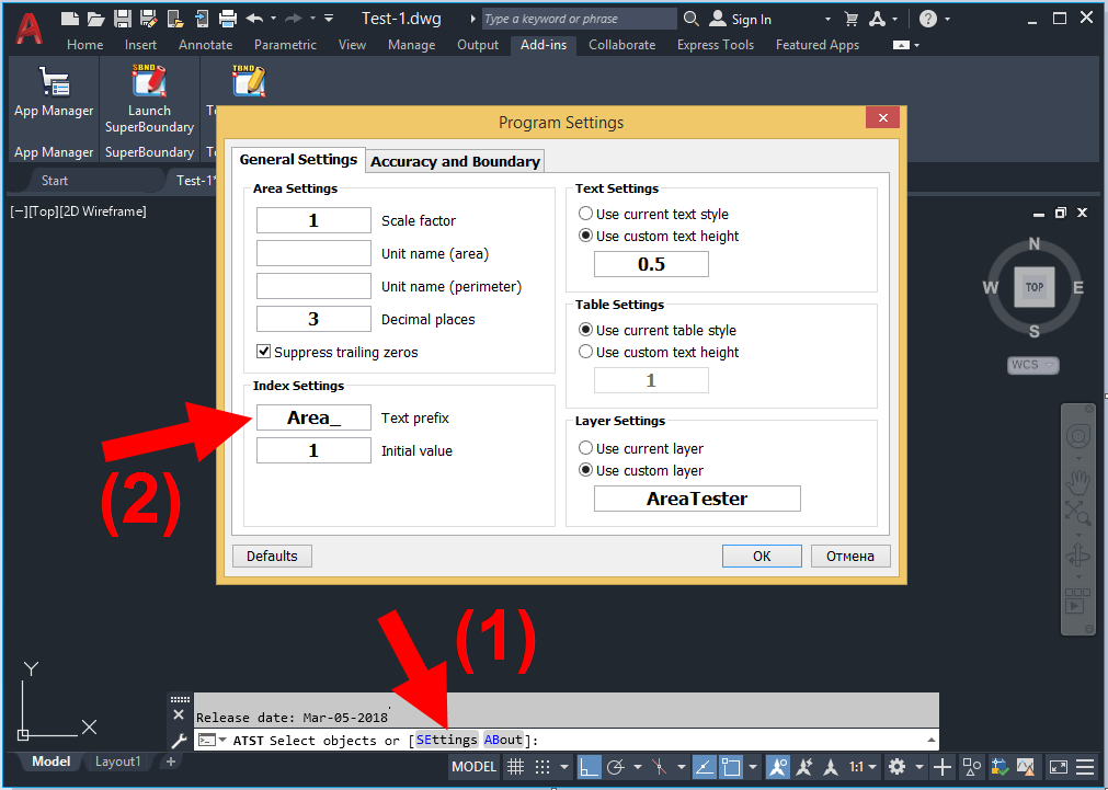

Debalance Posted April 27, 2020 Author Posted April 27, 2020 Hi, andreabag! After lauching the app at the command line, you need to select the "Settings" option (1). After that, in the dialog box, you can set a text index prefix (2). Quote

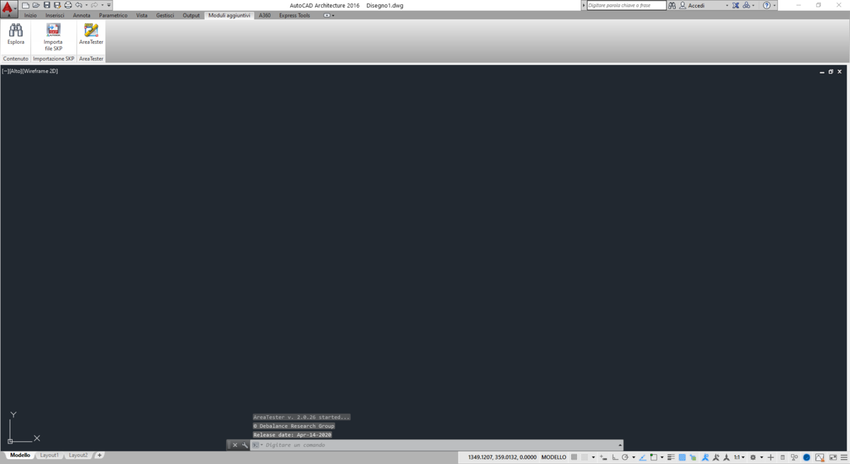

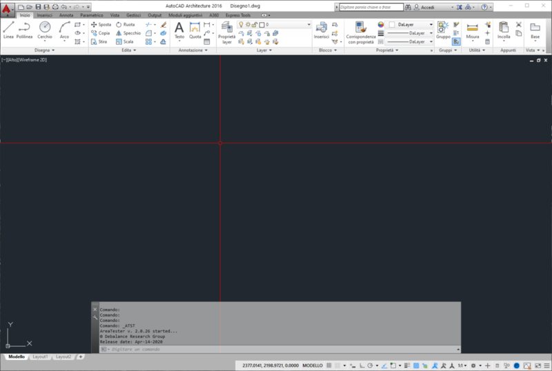

andreabag Posted April 27, 2020 Posted April 27, 2020 I don't see these options when I launch the app ...but the app only works if I first select the objects and then launch it.can you help me?I'll show you a screenshot Thanks Quote

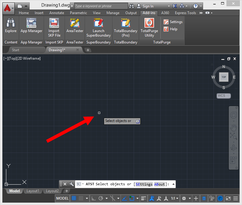

Debalance Posted April 27, 2020 Author Posted April 27, 2020 What happens if you just click on the icon without objects selection? Quote
Debalance Posted April 27, 2020 Author Posted April 27, 2020 Try manually entering the _ATST command in the command line. Quote
andreabag Posted April 27, 2020 Posted April 27, 2020 2 hours ago, Debalance said: What happens if you just click on the icon without objects selection? Nothing like in the screen shotI must first select objects then click on the icon. 45 minutes ago, Debalance said: Try manually entering the _ATST command in the command line. Same thing I wrote above ... Quote

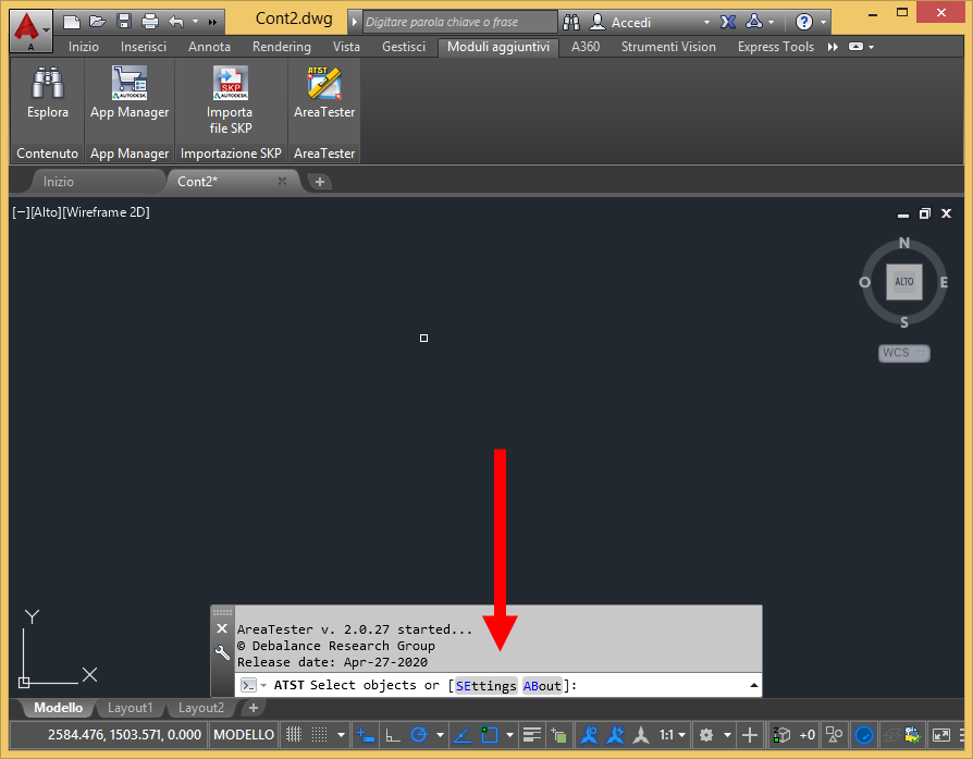

Debalance Posted April 27, 2020 Author Posted April 27, 2020 Can you enter the following command: _ATST SE Quote
andreabag Posted April 27, 2020 Posted April 27, 2020 9 minutes ago, Debalance said: Can you enter the following command: _ATST SE I'm sorry but I can't write a command followed by a space ...is considered to be Enter... Quote
andreabag Posted April 27, 2020 Posted April 27, 2020 1 hour ago, Debalance said: Don't you see the cursor too? I'm sorry no... If I don't select anything, the app starts and ends without allowing me to do anything. Quote

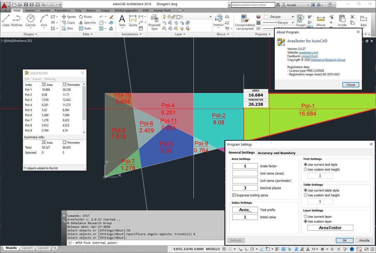

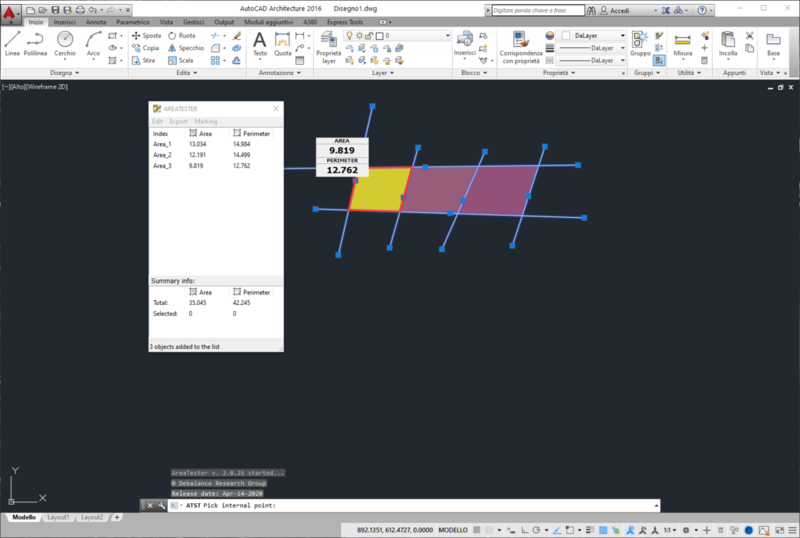

Debalance Posted April 28, 2020 Author Posted April 28, 2020 13 hours ago, andreabag said: I'm sorry no... If I don't select anything, the app starts and ends without allowing me to do anything. I have tested the app on the Italian version of AutoCAD and found a localization bug. I updated the AreaTester app. You can download the new version via this link. Now the app should work correctly: Thank you for your assistance! Quote
andreabag Posted April 28, 2020 Posted April 28, 2020 1 hour ago, Debalance said: Thank you for your assistance! Hi Perfect! I installed the new version and everything works fine. Thanks to you, it was a pleasure to be able to help you! 1 Quote
Debalance Posted April 28, 2020 Author Posted April 28, 2020 11 minutes ago, andreabag said: Perfect! I installed the new version and everything works fine. Thank you for your contribution to updating the app. I will be happy to answer any questions about using the AreaTester. Quote
