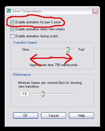

lpseifert Posted January 29, 2009 Posted January 29, 2009 Look into the sysvars Vtenable, Vtduration, Vtfps Quote

smorales02 Posted January 29, 2009 Posted January 29, 2009 I messed with vtoptions but i am not seeing a difference???? Quote
stevsmith Posted January 29, 2009 Posted January 29, 2009 I messed with vtoptions but i am not seeing a difference???? It works in vanilla. It gives you an optin to turn on the zoom animation, see if it is on. If it is off and adjust the rate it will not work. Quote
