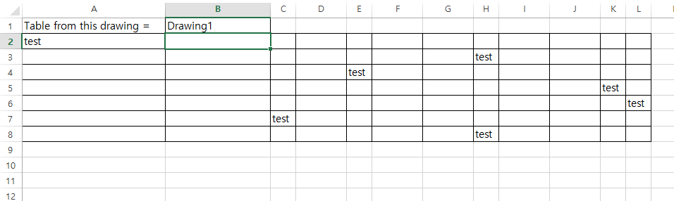

On 10/27/2019 at 3:21 PM, hosneyalaa said:
(defun c:tbltoex ()
  (pl:export-to-excel)
) ;_ end of defun
(defun c:tbltoexwithfilename ()
  (pl:export-to-excel-withfilename)
) ;_ end of defun

        (setq filenametxt (substr (getvar "dwgname") 1 (- (strlen (getvar "dwgname")) 4)) )
        (setq dat (append (list (list (strcat "Table from this drawing = ") filenametxt )) dat))

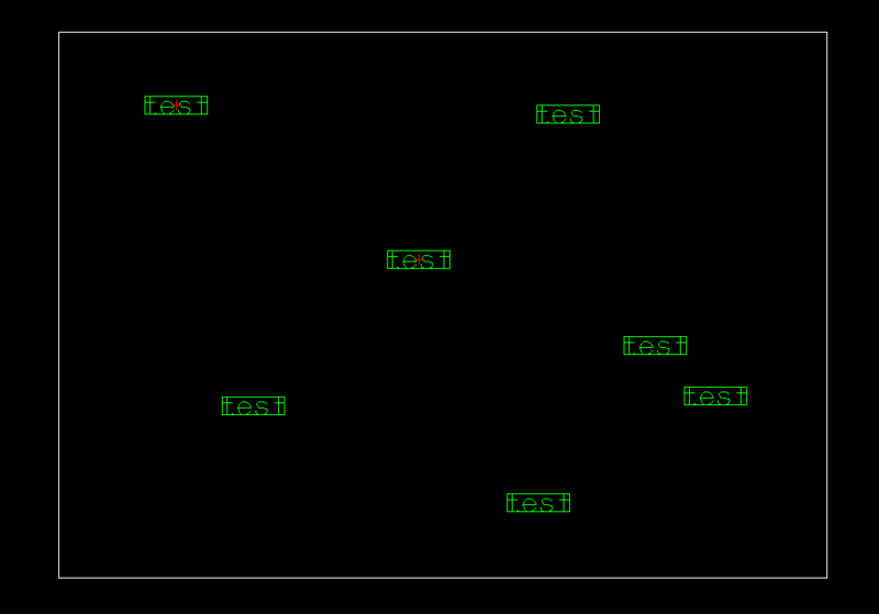

(defun pl:get-tbl-ents (/ _box)
  (setq
    _box
     (vl-catch-all-apply
       (function
         (lambda (/ corn1 corn2)
           (if
             (and (setq corn1
                         (getpoint
                           "\nSelect TopLeft Corner of Table <Exit>: "
                         ) ;_ end of getpoint
                  ) ;_ end of setq
                  (setq corn2
                         (getcorner
                           corn1
                           "\nSelect BottomRight Corner of Table <Exit>: "
                         ) ;_ end of getcorner
                  ) ;_ end of setq
                  (setq corn1 (polar corn1 (dtr 135) (/ (distance corn1 corn2) 200) ))    ; add this for leaking problem with first line
                  (setq corn2 (polar corn2 (dtr 315) (/ (distance corn1 corn2) 200) ))    ; add this for leaking problem with last line
             ) ;_ end of and
              (list corn1 corn2)
           ) ;_ end of if
         ) ;_ end of lambda
       ) ;_ end of function
       nil
     ) ;_ end of vl-catch-all-apply
  ) ;_ end of setq
  (if (cond ((not _box) (princ "\nNo selection") nil)
            ((vl-catch-all-error-p _box)
             (princ (strcat "\n" (vl-catch-all-error-message _box)))
             nil
            (t
             (setq _box (list (list (min (caar _box) (caadr _box))
                                    (max (cadar _box) (cadadr _box))
                              ) ;_ end of list
                              (list (max (caar _box) (caadr _box))
                                    (min (cadar _box) (cadadr _box))
                              ) ;_ end of list
                        ) ;_ end of list
             ) ;_ end of setq
      ) ;_ end of cond
    (list _box
          (ssget "_C" (car _box) (cadr _box) '((0 . "LINE")))
          (ssget "_C" (car _box) (cadr _box) '((0 . "LWPOLYLINE")))
          (ssget "_C" (car _box) (cadr _box) '((0 . "TEXT")))
    ) ;_ end of list
  ) ;_ end of if
) ;_ end of defun

and add little command for export filename at first 2 cells
command : tbltoexwithfilename
3.
and I realized that if I used this with http://www.lee-mac.com/boxtext.html
can output the distributed text to the cells that fit the position.
bt with 0 spacing for all text
then tbltoex
then undo twice for delete bt, Excel is not undoed, so only boxtext will be deleted.

I merged the code in the link into tbltoex.
It would be nice if I could handle properly😅
With bounding boxes, I think the first box would be unnecessary, but it was difficult to decipher it.
this is temporary function for my works (to export rotated call outs)
tbltoextest command.
select range of texts
then lisp will make box of those texts
select again same range (for use same function module)
when excel processing is done,
input space bar in CAD to delete boxes.
