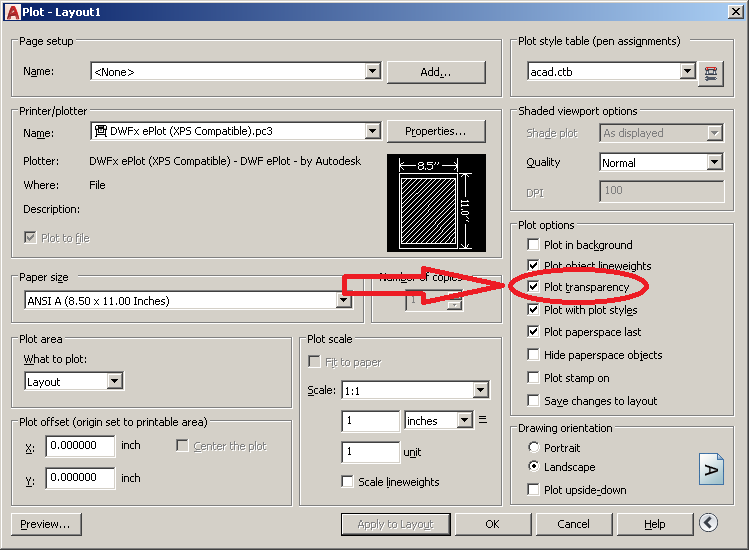

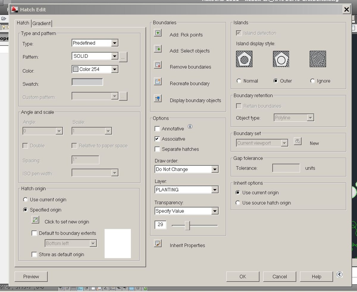

I am having difficulty trying to add transparency to a solid hatch. I think that I have all the correct boxes ticked (image attached), but when I check via a print preview, it appears black solid. Not too sure why this is not working for me... any suggestions? THANK YOU so much in advance for any help.
If Plot Transparency is ticked, try increasing the transparency value, 29 isn't very much for a solid hatch.
  • Like 2
+1 to SLW and also be aware that sometimes printing directly to a printer or plotter can fail with transparent hatches. I have found that it works best for me to print to a PDF 1st and then print this file to a printer/plotter. Good luck.
OMGoodness... you guys are GENIUSES and have saved my hide more times than I care to admit! THANK YOU!!!
