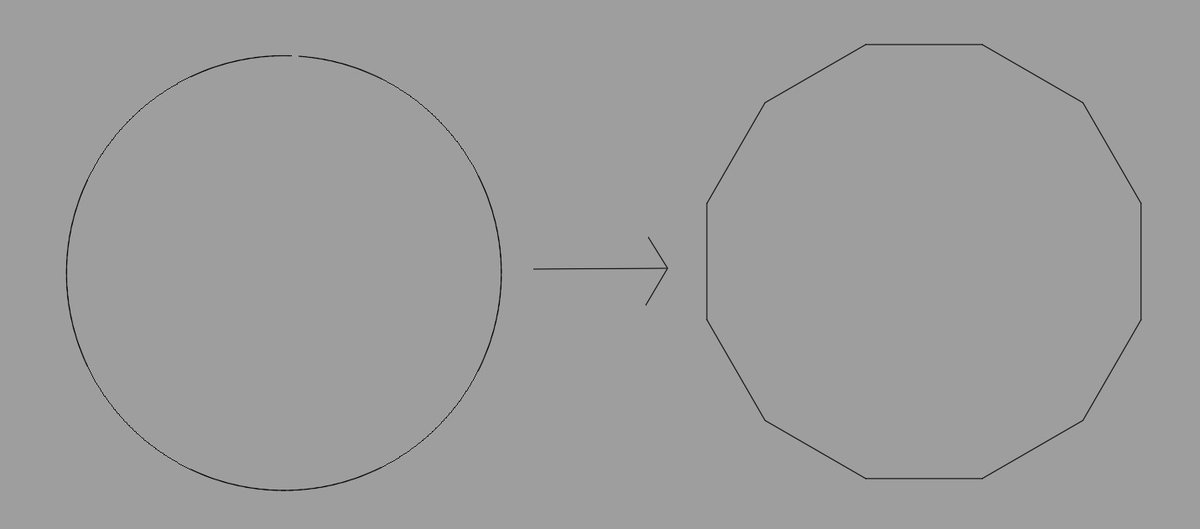

Alanus Posted October 22, 2019 Share Posted October 22, 2019 So I'm currently working on a proyect where I need all my circles and round shaped to be easy to edit on 3ds max if needed. The problem is that I have some polylines on these CADs with over 100 points, making them very hard to use. The question is: Is there any way to modify the amount of points there that isn't manually? Quote Link to comment Share on other sites More sharing options...

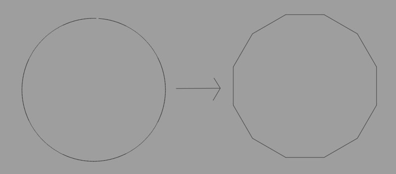

BIGAL Posted October 24, 2019 Share Posted October 24, 2019 (edited) If your shape is say a polygon in Autocad then you could just get all the vertices, and remake it with some factor like 2 3 ie every second vertice is removed. Will have a look at put obj 'coordinates. Or just use a simple make a new one. Edited October 24, 2019 by BIGAL Quote Link to comment Share on other sites More sharing options...
Cad64 Posted October 24, 2019 Share Posted October 24, 2019 11 hours ago, Alanus said: This is EXACTLY what I've been looking for for months! While the Weed lisp routine is great for reducing the number of points on a polyline, I'm not sure it would be a good solution for something like a polygon that needs to be symmetrical. For the example of a circle with 100 points, the Weed routine would certainly be able to reduce the number of points, but there's no guarantee that it will maintain the shape correctly. It might remove more points on one side and less on another side and you could end up with some lopsided circles. If it were up to me, I would redraw the polygons manually to insure proper symmetry. Quote Link to comment Share on other sites More sharing options...
BIGAL Posted October 24, 2019 Share Posted October 24, 2019 (edited) Not sure what happened but lost code from here. Will redo again. Please note the CMDactive crashes Briscad. Will look into it. ; reduce polygon facets by AlanH OCT 2019 (defun c:polred ( / x R lst co-ord plent) (setq plent (entsel "pick polygon")) (if plent (setq co-ord (mapcar 'cdr (vl-remove-if-not '(lambda (x) (= (car x) 10)) (entget (car plent)))))) (setq R (getint "Enter reduction factor 2 3 4 etc")) (setq x 0) (setq lst '()) (setq lst (cons (nth x co-ord) lst)) (repeat (- (/ (length co-ord) R) 1) (setq lst (cons (nth (setq x (+ x R)) co-ord) lst)) ) (setvar 'clayer "0") ; add your layer or else erase plent ;(command "erase" plent "") (command "_pline") (while (= (getvar "cmdactive") 1 ) (repeat (setq x (length lst)) (command (nth (setq x (- x 1)) lst)) ) (command "C") ) ) (c:polred) Edited October 24, 2019 by BIGAL 1 Quote Link to comment Share on other sites More sharing options...

Alanus Posted October 24, 2019 Author Share Posted October 24, 2019 3 hours ago, SLW210 said: Do you have an example drawing? You may have better luck with PLDIET.LSP and the Express Tool OVERKILL will clean up some things as well. Could the drawings need to be flattened? Actually, I didn't even find the WEED.lsp one, but when I searched for it this one came up as the only result and worked perfectly Quote Link to comment Share on other sites More sharing options...
