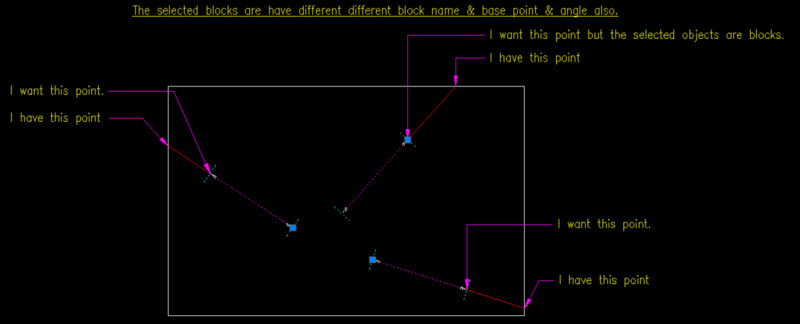

Pugazh Posted October 21, 2019 Posted October 21, 2019 (edited) Hi, i need this block point. please see attached file. Edited October 21, 2019 by Pugazh Quote
Emmanuel Delay Posted October 21, 2019 Posted October 21, 2019 How do we know the length between the block insert point and the point you're looking for? 1 Quote

Pugazh Posted October 24, 2019 Author Posted October 24, 2019 Hi @Emmanuel Delay, This is i need, how to get block nearest endpoint or perpendicular point from the entsel. (list "ARC" "LINE" "LWPOLYLINE" "RAY" "SPLINE" "XLINE")) See my attached file, the blocks are selected. did you see block insert point?. blocks insert point is enough for me but they blocks are have different rotation. So i need block endpoint from the entsel. Quote
dlanorh Posted October 24, 2019 Posted October 24, 2019 7 hours ago, Pugazh said: Hi @Emmanuel Delay, This is i need, how to get block nearest endpoint or perpendicular point from the entsel. (list "ARC" "LINE" "LWPOLYLINE" "RAY" "SPLINE" "XLINE")) See my attached file, the blocks are selected. did you see block insert point?. blocks insert point is enough for me but they blocks are have different rotation. So i need block endpoint from the entsel. Blocks don't have endpoints, only insertion points. So lets assume these are dimensions (they are saved as anonymous blocks), is that correct? 1 Quote
Pugazh Posted October 27, 2019 Author Posted October 27, 2019 Hi @dlanorh, Sorry for the late reply, maybe these are dimensions (they are saved as anonymous blocks). please see the attached sample file. Block.dwg Quote

dlanorh Posted October 27, 2019 Posted October 27, 2019 (edited) Try this. Tested with your block, and will only work with this block. It is an in-elegant short notice solution. The block is composed of a line and four nested blocks. The block is copied, the copy is then exploded and nested blocks removed leaving the line. The end points of the line are tested against the original blocks insertion point and the non-matching coordinate is returned. All created objects are deleted. (defun rh:oppend ( obj / n_obj b_objs l_obj s_pt e_pt rtn) (if (= (type obj) 'ENAME) (setq obj (vlax-ename->vla-object obj))) (cond ( (= "AcDbBlockReference" (vlax-get obj 'objectname)) (setq n_obj (vla-copy ent) b_objs (vlax-invoke n_obj 'explode) l_obj (car (vl-remove-if-not '(lambda (x) (= (vlax-get x 'objectname) "AcDbLine")) b_objs)) s_pt (vlax-get l_obj 'startpoint) e_pt (vlax-get l_obj 'endpoint) ) (vla-delete n_obj) (mapcar '(lambda (x) (vla-delete x)) b_objs) (if (equal (vlax-get obj 'insertionpoint) s_pt 0.001) (setq rtn e_pt) (setq rtn s_pt)) ) );end_cond rtn );end_defun ;; ##### HOW TO USE ##### (setq e_pt (rh:oppend entity)) ; will accept a block entity or a block object. The return (the point you want) will be in the variable e_pt) Edited October 27, 2019 by dlanorh Quote

hanhphuc Posted October 28, 2019 Posted October 28, 2019 1 hour ago, Pugazh said: i got this Error : bad argument type: VLA-OBJECT (setq n_obj (vla-copy ent) (vla-copy obj) 1 Quote
Pugazh Posted October 28, 2019 Author Posted October 28, 2019 1 hour ago, hanhphuc said: (setq n_obj (vla-copy ent) (vla-copy obj) (defun rh:oppend ( obj / n_obj b_objs l_obj s_pt e_pt rtn) (if (= (type obj) 'ENAME) (setq obj (vlax-ename->vla-object obj))) (cond ( (= "AcDbBlockReference" (vlax-get obj 'objectname)) (setq n_obj (vla-copy obj) b_objs (vlax-invoke n_obj 'explode) l_obj (car (vl-remove-if-not '(lambda (x) (= (vlax-get x 'objectname) "AcDbLine")) b_objs)) s_pt (vlax-get l_obj 'startpoint) e_pt (vlax-get l_obj 'endpoint) ) (vla-delete n_obj) (mapcar '(lambda (x) (vla-delete x)) b_objs) (if (equal (vlax-get obj 'insertionpoint) s_pt 0.001) (setq rtn e_pt) (setq rtn s_pt)) ) );end_cond rtn );end_defun i just checked (setq e_pt (rh:oppend (ssget))) I got same Error : bad argument type: VLA-OBJECT Quote
hanhphuc Posted October 28, 2019 Posted October 28, 2019 1 hour ago, Pugazh said: (defun rh:oppend ( obj / n_obj b_objs l_obj s_pt e_pt rtn) (if (= (type obj) 'ENAME) (setq obj (vlax-ename->vla-object obj))) (cond ( (= "AcDbBlockReference" (vlax-get obj 'objectname)) (setq n_obj (vla-copy obj) b_objs (vlax-invoke n_obj 'explode) l_obj (car (vl-remove-if-not '(lambda (x) (= (vlax-get x 'objectname) "AcDbLine")) b_objs)) s_pt (vlax-get l_obj 'startpoint) e_pt (vlax-get l_obj 'endpoint) ) (vla-delete n_obj) (mapcar '(lambda (x) (vla-delete x)) b_objs) (if (equal (vlax-get obj 'insertionpoint) s_pt 0.001) (setq rtn e_pt) (setq rtn s_pt)) ) );end_cond rtn );end_defun i just checked (setq e_pt (rh:oppend (ssget))) I got same Error : bad argument type: VLA-OBJECT It's different time zone, i think @dlanorh will soon reply if he wakes up, so please be patient. His rh:oppend sub function requires single ENAME or VLA-OBJECT type as argument, not a PICKSET (selectionset) (rh:oppend (car(entsel)) ) ; ENAME (rh:oppend (ssname (ssget) 0)) ; first item in selection set you can use repeat, while, foreach loop to iterate in selection set. 1 Quote

dlanorh Posted October 28, 2019 Posted October 28, 2019 2 hours ago, Pugazh said: (defun rh:oppend ( obj / n_obj b_objs l_obj s_pt e_pt rtn) (if (= (type obj) 'ENAME) (setq obj (vlax-ename->vla-object obj))) (cond ( (= "AcDbBlockReference" (vlax-get obj 'objectname)) (setq n_obj (vla-copy obj) b_objs (vlax-invoke n_obj 'explode) l_obj (car (vl-remove-if-not '(lambda (x) (= (vlax-get x 'objectname) "AcDbLine")) b_objs)) s_pt (vlax-get l_obj 'startpoint) e_pt (vlax-get l_obj 'endpoint) ) (vla-delete n_obj) (mapcar '(lambda (x) (vla-delete x)) b_objs) (if (equal (vlax-get obj 'insertionpoint) s_pt 0.001) (setq rtn e_pt) (setq rtn s_pt)) ) );end_cond rtn );end_defun i just checked (setq e_pt (rh:oppend (ssget))) I got same Error : bad argument type: VLA-OBJECT You said in an earlier post Quote This is i need, how to get block nearest endpoint or perpendicular point from the entsel. You cannot send it a selection set. As @hanhphuc mentioned you will need to process any selection set in a loop (repeat (setq cnt (sslength ss)) (setq e_pt (rh:oppend (ssname ss (setq cnt (1- cnt))))) ;; ;; ;;Rest of your code here to do what you want ;; ;; );end_repeat I don't know what you are trying to do with the points you have. Perhaps an explanation would help. Quote
