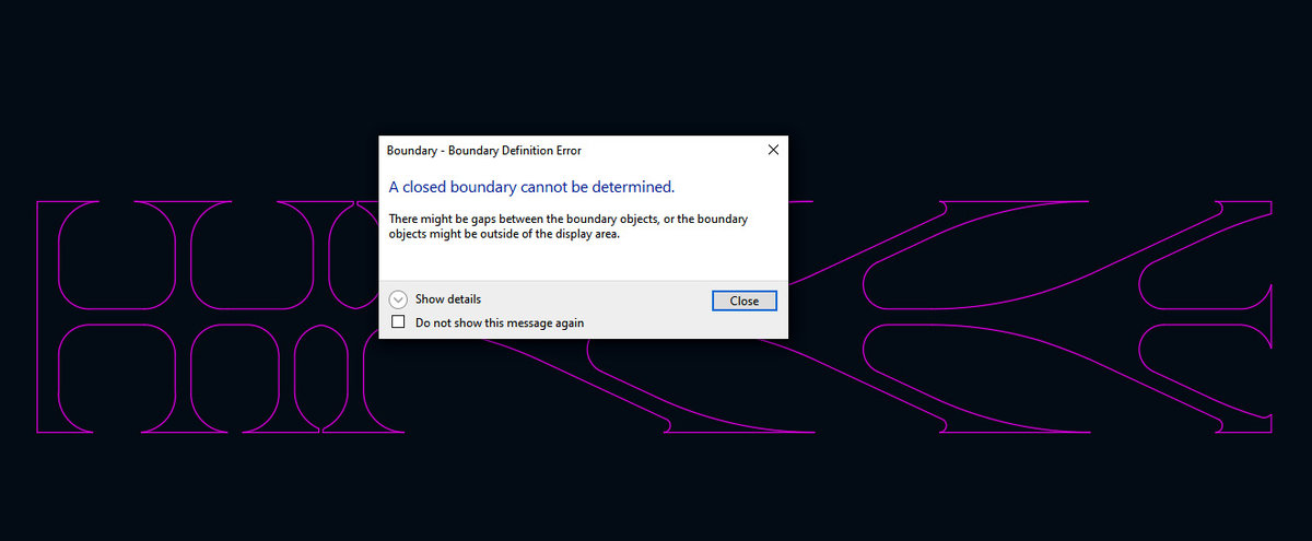

smileforrest Posted October 18, 2019 Posted October 18, 2019 When i hatch a drawing like the one below, it occurs "boudary definiton error". But the drawing is defined by a single 2d boundary poly line. And I uploaded the drawing in the appendix. I'll be very appriciated if someone can give some help! error_hatch.dwgFetching info... Quote
Cad64 Posted October 18, 2019 Posted October 18, 2019 I ran the BOUNDARY command on your drawing and got the error below. You will need to check all your endpoints and make sure all the line segments are indeed connected. Quote

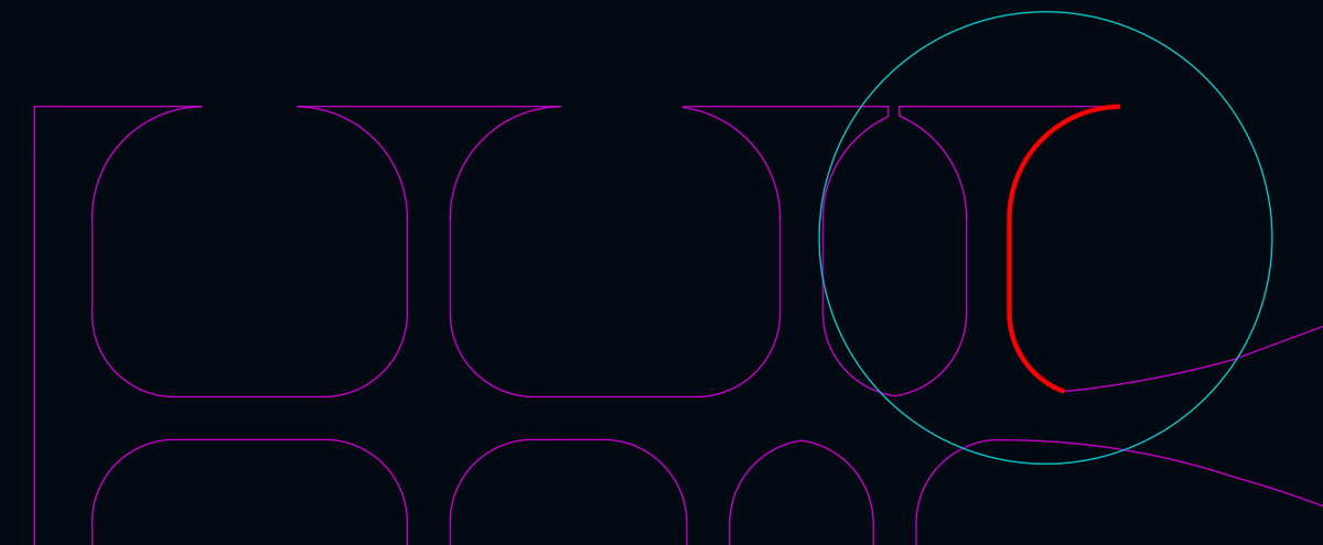

Cad64 Posted October 18, 2019 Posted October 18, 2019 I just did a quick check and found a bad segment in your linework. Replace the segment in red below and you will be able to hatch. Quote

Dana W Posted October 18, 2019 Posted October 18, 2019 I am running 2019 LT at work and I get this below whether I execute BOUNDARY or pick an internal point. I have investigated the vertices circled and can't find anything wrong zoomed WAY way in. Press the expand arrow on the error message. PEDIT tells me it is closed, it won't offer CLOSE to do, only OPEN. I see nothing about a bad segment. I can hatch with no issues by selecting the object rather than picking a point. Quote
Cad64 Posted October 18, 2019 Posted October 18, 2019 Yeah, I actually didn't try hatching, since the OP said it wasn't working. I just ran the Boundary command and got the error message. I just went back and tried hatching the object, without replacing any segments, and it works fine. So, I'm not sure why the Boundary command throws up an error and I'm not sure why the OP can't hatch? It's all very strange. Edit: After further investigation, I don't think that segment I mentioned is actually bad. It doesn't make a difference if I replace it or not. The Boundary command still throws an error. But I can hatch the object with no problem, without replacing any segments. Quote
