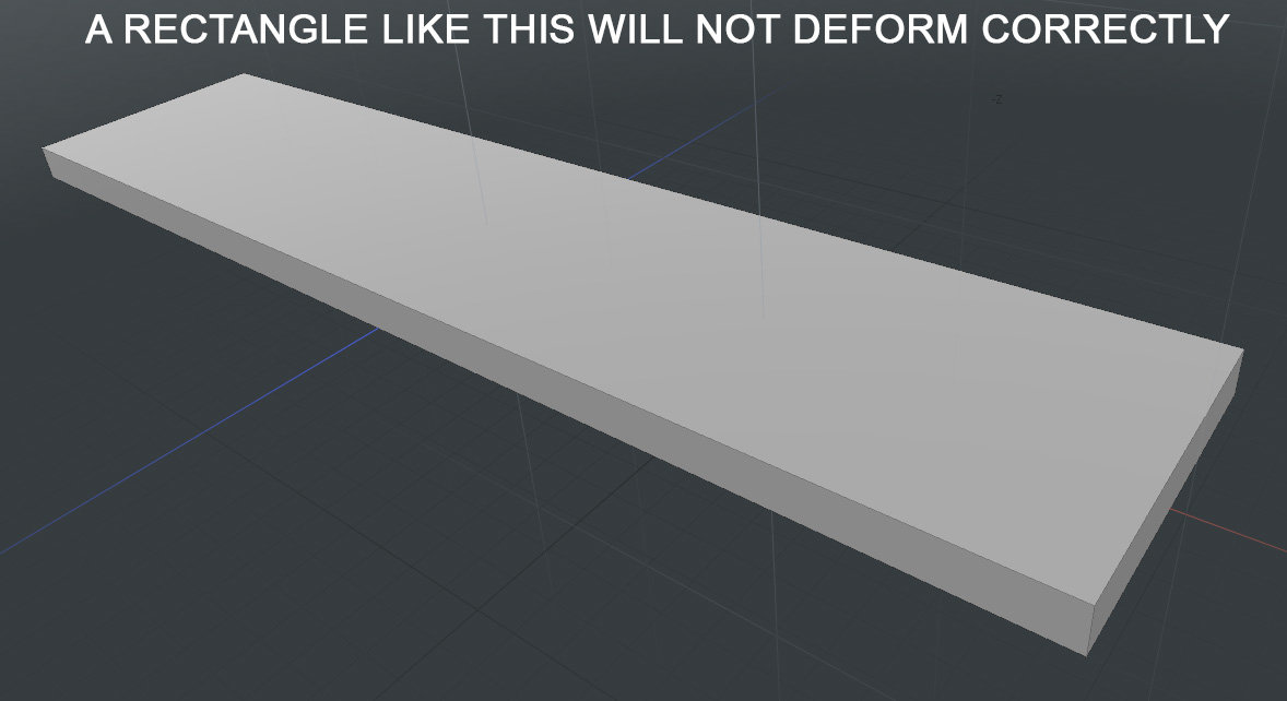

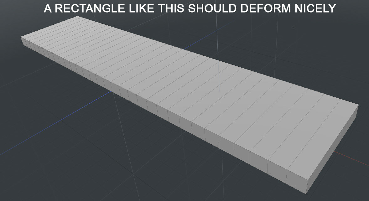

It looks like the rectangle may not have any enough topology in order to deform around the circle. You may already know this, but if you don't, take a look at the images below. A rectangle with no topology will not deform when you try to bend it, but a rectangle with a good amount of topology, will deform correctly when you bend it.
