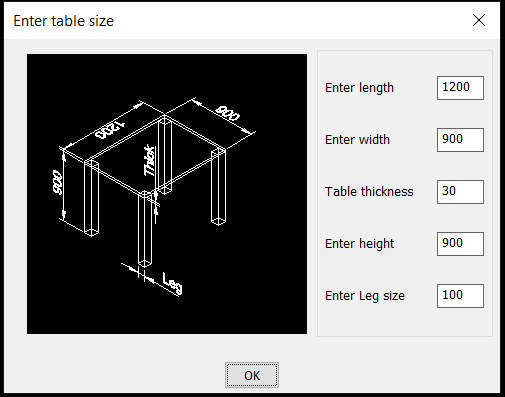

Well had another go at a further library routine, why not a image as well as input boxes so describing what is required.
To run just edit last line so it can find the sld, you can try your own the siz makes the image bigger or smaller. Change list to your input. Normally run with out last line just use the if not to load as a library routine. example at top. Will look into vector image should improve quality
ps took 2 days to work out "Label" does not work must be lower case, such a simple mistake.
Multi GETVALS Img.lsp Furntable.sld
Edited by BIGAL
