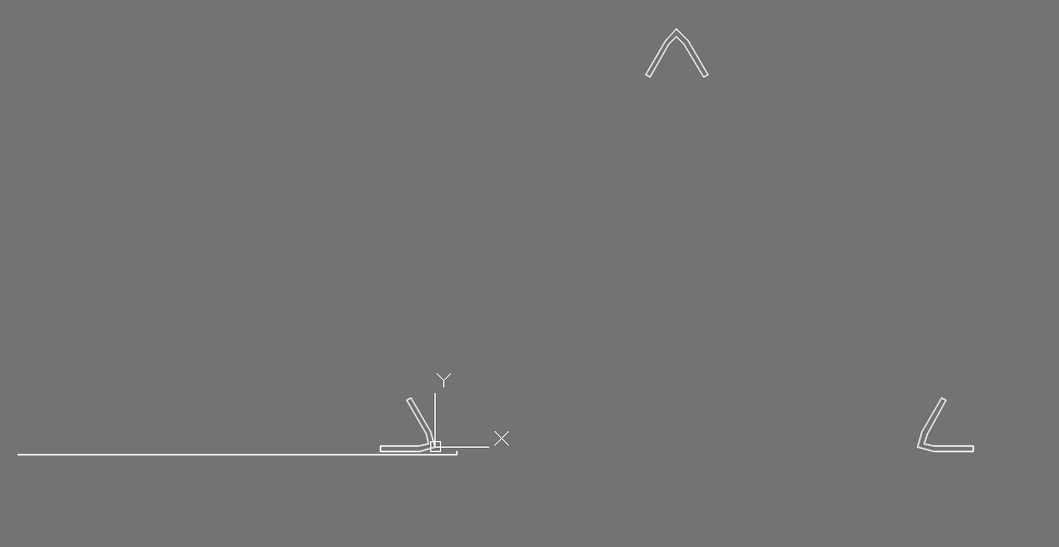

Sambuddy Posted October 21, 2019 Author Posted October 21, 2019 This the excel input; DATA_1.scrFetching info... test.dwgFetching info... Quote
Sambuddy Posted October 21, 2019 Author Posted October 21, 2019 I think I am messing up with the (-) negative as a start of my coordinates. By removing them and running the lisp now I am getting: rlx? could this be the cause you think? Quote
rlx Posted October 21, 2019 Posted October 21, 2019 Compared variables and couldn't find significant differences. I runned my script in your drawing and it performed as suspected. Only (stupid / silly) way could be to run your script file thru a lisp. Don't expect it to make much difference but then , you've nothing to lose... (defun c:t1 ( / fn fp cmd) (if (and (setq fn (getfiled "Select script" "" "scr" 0))(setq fp (open fn "r"))) (while (setq cmd (read-line fp))(command cmd))) (if fp (close fp)) (princ)) (defun c:t2 ( / fn fp cmd cmd-list) (if (and (setq fn (getfiled "Select script" "" "scr" 0))(setq fp (open fn "r"))) (while (setq cmd (read-line fp))(setq cmd-list (cons cmd cmd-list)))) (if fp (close fp))(mapcar 'command (reverse cmd-list)) (princ)) both codes do the same , just tried two approaches but there are more like command-s , vl-cmdf and with error checking thr vl-catch-all-apply but think that would be overkill... Quote

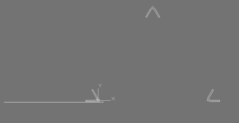

Sambuddy Posted October 22, 2019 Author Posted October 22, 2019 rlx, You have outdone yourself once more! I thank you for all your time and effort in producing this lisp (t4). However simple it may look to you, it is amazing how you can write your codes with little to no information I have given you and then your magic of coding happens! Thank you again Quote

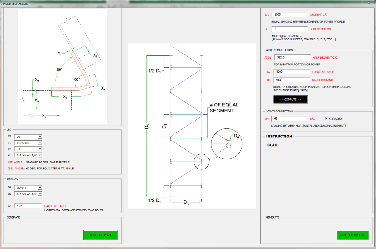

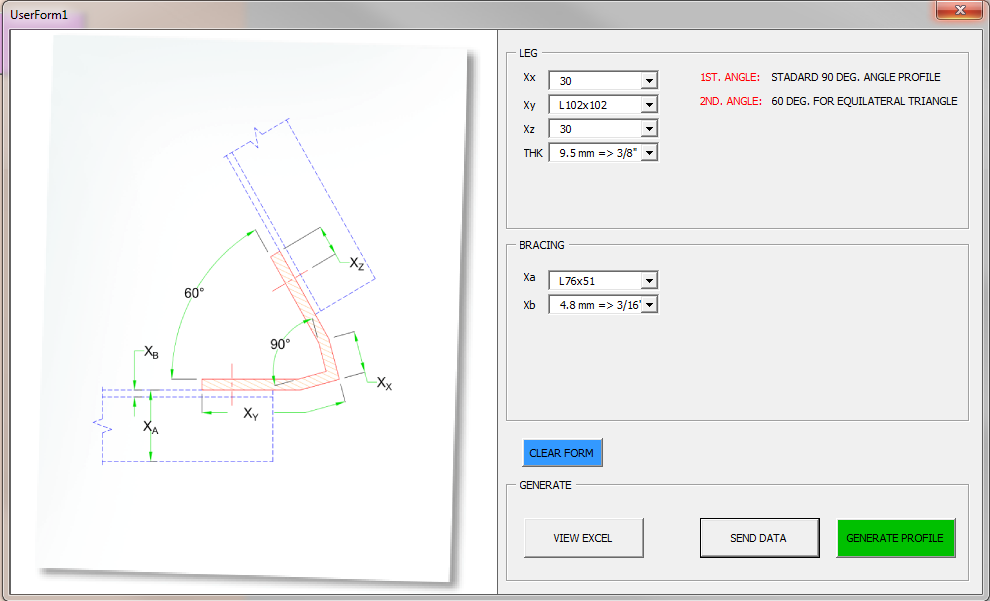

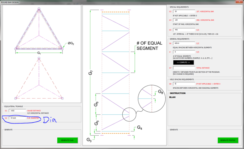

Sambuddy Posted October 24, 2019 Author Posted October 24, 2019 Hey rlx, Your LISP (T4) does magic - the userform I created in excel is all plines for the first form as below and the result is just gorgeous: now that I am doing for second userform in excel, I am facing with another problem. Below is the form: As it happens I have some circle to draw - is there a way for your second LISP (say T5) to draw that up for me? My txt files are unique for every application - so for example my txt files for these three circles are data121.txt, data122.txt and data 123.txt. Could this exception be incorporated into the LISP? I especially likes not to use pline and close in every frickin coordinate on your previous LISP. Thanks rlx again Quote
rlx Posted October 25, 2019 Posted October 25, 2019 I suppose by getting all text files in a dedicated folder and by looking at their names you would be able to say 1-99 is pline , 100-200 is circle etc. Quote

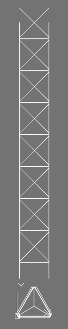

Sambuddy Posted November 14, 2019 Author Posted November 14, 2019 Special thanks to rlx for your LISP - I just posted a message on the tower profile post. I just finished completing the excel portion and with your elegant LISP I can now bring all my data right into cad so... Thanks rlx Quote
