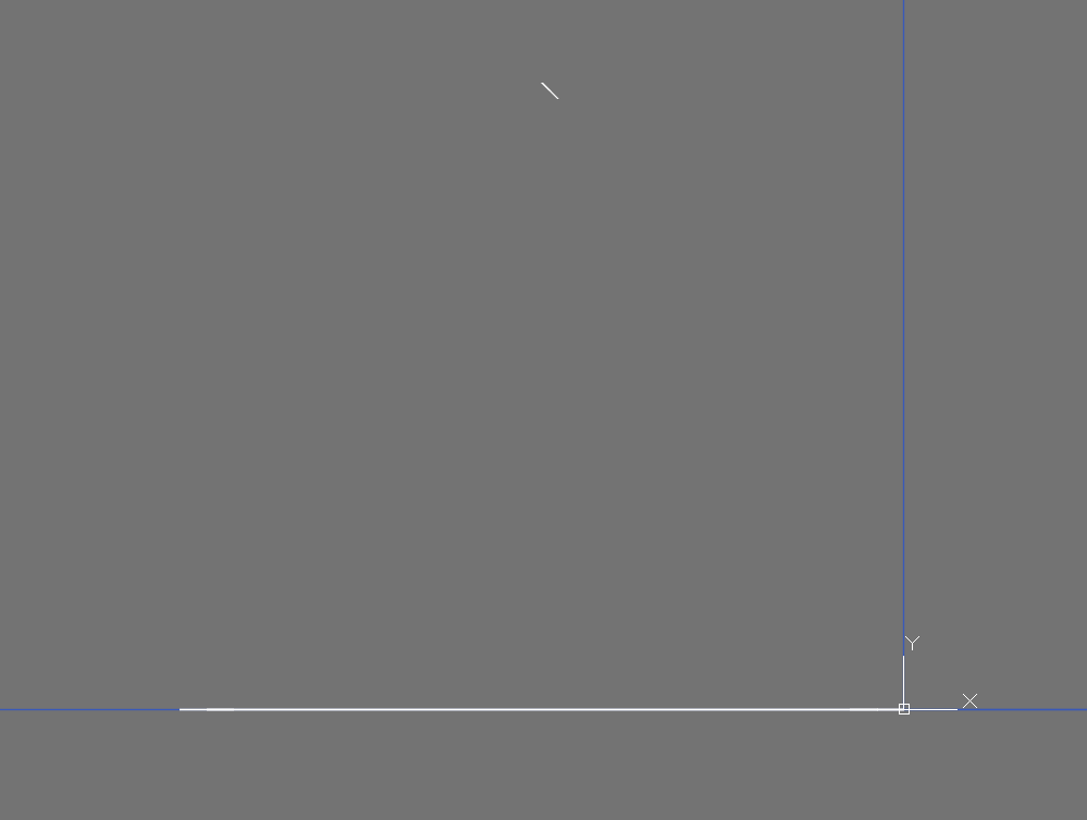

lrm Posted October 18, 2019 Posted October 18, 2019 On 10/17/2019 at 7:59 PM, Sambuddy said: Thanks for that tip. I will try to use it next time. But on the script itself: how do I make the command cancel after executing itself, example pline? Now that I added 3 pline commands under one script, it seems to give me a messed up drawing with the LISP, but when I paste it directly onto the commandline everything seems fine. Am I doing something wrong here? Could you please help? when I run the LISP, it gives me this: Specify start point: pline Invalid point. This is what I have on the blah.scr: pline 0,0 @30<195 @97<180 @7.9375<90 @95.9550083004<0 @21.0175083004<15 @21.0175083004<105 @95.9550083004<120 @7.9375<30 @97<300 close pline -933.955549577344,0 @30<75 @97<60 @7.9375<330 @95.9550083004<240 @21.0175083004<255 @21.0175083004<345 @95.9550083004<0 @7.9375<270 @97<180 close pline -466.977774788672,808.829231939437 @30<315 @97<300 @7.9375<210 @95.9550083004<120 @21.0175083004<135 @21.0175083004<225 @95.9550083004<240 @7.9375<150 @97<60 close close Expand When I copied and pasted the above script into Notepad it showed, as @rlx noted, blank lines between the close and pline statements. The script also has two close statements and several blank lines at the end. The last script statement should be followed by one "enter" but that's it. Additional blank lines will force a re-execution of the last command given, in your script that's pline. Removing the extraneous blank lines and the extra close statement should given you a good script. Regarding using AutoCAD/VBA it theoretically could be done. If your code were implemented in AutoCAD/VBA you would just needed to create an array variable to hold the coordinates of the pline that you are now calculating for the script and then make a call to addpoly. I don't know if the VBA forms you created would transfer. I have tried several times to instal AutoCAD/VBA and have never been successful. It appears to me that Autodesk has abandoned VBA in favor of .net and vlisp. Quote

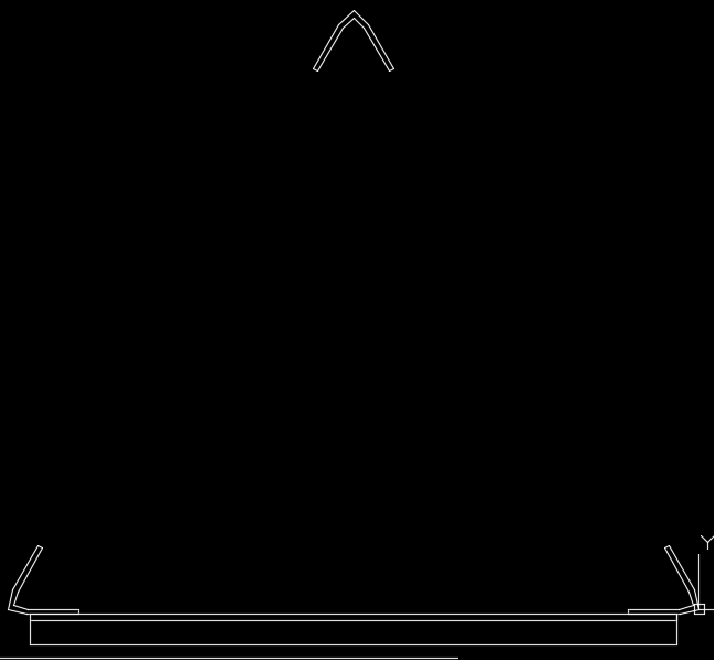

Sambuddy Posted October 21, 2019 Author Posted October 21, 2019 Thank you all for your inputs for this question. Again the problem was not combining the three or more scripts since I can get the VBA excel to give me a unified script by: Dim iCntr Dim strFile_Path As String Set ssheet2 = ThisWorkbook.Sheets("DATA_1") strFile_Path = "C:\temp\DATA_1.scr" Open strFile_Path For Output As #1 For iCntr = 1 To 85 Print #1, ssheet2.Range("A" & iCntr) Next iCntr Close #1 End Sub the problem lies when I attempt to execute it onto CAD - all scripts at once. It appears when I execute them separately the seems to draw perfectly fine but when I combine them it comes up all messed up - the reason I asked if it was possible for one lisp, one command and multiple sub-commands to bypass this issue. you will see, as you all pointed out that when you copy and paste directly from the notepad file onto commandline everything draw nice but when I execute the same notepad - now as script - it draws all messed up. thanks for your input anyways Quote
Sambuddy Posted October 21, 2019 Author Posted October 21, 2019 I am not sure how I might be missing an extra space with all three combined when I can copy and paste directly for it to be fine. DATA_1.scrFetching info... pline 0,0 @25.4<195 @63.5<180 @6.35<90 @62.66400664032<0 @18.21400664032<15 @18.21400664032<105 @62.66400664032<120 @6.35<30 @63.5<300 close pline -866.069031975485,0 @25.4<75 @63.5<60 @6.35<330 @62.66400664032<240 @18.21400664032<255 @18.21400664032<345 @62.66400664032<0 @6.35<270 @63.5<180 close pline -433.034515987742,750.037783121767 @25.4<315 @63.5<300 @6.35<210 @62.66400664032<120 @18.21400664032<135 @18.21400664032<225 @62.66400664032<240 @6.35<150 @63.5<60 close pline -28.0345159877423,-6.57400374560403 @7.9375<270 @810<180 pline -28.0345159877423,-6.57400374560403 @810<180 @38.1<270 @810<0 @38.1<90 close I tried this one with all alternative combinations of removing plines, adding spaces, removing CLOSE - it just does not work when I execute the LISP. Quote

rlx Posted October 21, 2019 Posted October 21, 2019 (edited) You have a S...t load of empty lines at the end of your script. Each and every empty line reacts as enter (= repeat command) When you use close the pline command stops by itself so no need for empty line between close and next pline command gr. RLX DATA_2.scrFetching info... Edited October 21, 2019 by rlx Quote

rlx Posted October 21, 2019 Posted October 21, 2019 (edited) what are the settings for your osnap? (getvar 'osmode).Or maybe better , post the drawing after you ran the script. Looks to me like either your precision / units are setup wrong or your osnap is 'gluing' your segments together. Why else would the script run ok for everyone else (or am I the ony one)? I can't think of anything else than a setting is messing up things. Edited October 21, 2019 by rlx Quote
rlx Posted October 21, 2019 Posted October 21, 2019 wow , that really looks like a buch of sticky lines... I must say my unit settings have even a lower precision. Now I'm no expert on 3d but your drawing also looks like a bunch of lines seeing sideways. Is it possible your ucs is not set to world? You could use the command 'plan' with option world. Or use the vpoint command to look in 3d to your drawing. But all and all , its blowing my mind why a simple script can cause such problems. Then again , my wife too can turn simple things into problems so is there such a thing as male and female scripts? Quote

rlx Posted October 21, 2019 Posted October 21, 2019 could you post (or mail) the actual drawing (with only the lines created by the script) or the xlsm. Maybe as a last resort comparing drawing settings could shed a light on this mystery. Although this probably doesn't explain why pasting the script does work. I do like a good mystery (but only if I can find the solution ). btw , is your autocad also French? I remember vaguely preceding commands with ._ makes sure the built in autocad commands are used , so ._pline and ._close. But I must admit I am slowly running out of ideas... Quote
