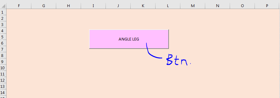

Sambuddy Posted October 16, 2019 Posted October 16, 2019 ANGLE LEG_SAMPLE.xlsxFetching info... I am sorry if got the category messed up, but could not find a category for my question so I will pose it here. Attached is the excel Polar coordinate I am trying to generate in Autocad. I used excel VBA to give me a polar coordinate based on the variables I entered. Is it possible for someone to tell me how I should write an Excel VBA to upon pressing a pre-defined button in excel (say: generate drawing) could open an Autocad file, get the data from this sample excel file and draw the lines. I was unsuccessful in LISP to do this, because I do not know much about LISP, the reason why I am involving excel in all these. i am successful in saving the coordinates as blah.scr and then go to autocad and enter script to then find the file and everything is good - but I am trying to reduce the number of steps by inserting a button on excel to do all this for me. the snapshot below is the userform I created in excel to give me the data in the excel file attached. Quote

Sambuddy Posted October 17, 2019 Author Posted October 17, 2019 Good morning Irm, I guess I sometimes even confuse myself! I did write a vba code (as I am not at all familiar with LISP) in excel and found a way for excel to give me Polar coordinates (excel file attached in earlier post). what i was asking is there is a way to either: 1) through vba coding: I could prompt autocad to draw the pline or, 2) a Lisp to execute the excel as either script or txt. Please note that my exported file will be in blah.scr for this example. I could simply run script command and then select the file directory and select the file but if there a way to automate this process I would certainly appreciate it. No I did not attach the file with the vba code because that is not what my question about, since I can ask excel to export a blah.scr for me. Thanksblah.scr Quote

steven-g Posted October 17, 2019 Posted October 17, 2019 Create a new command in the CUI place a macro to run your script, give it an icon or command name. ^C^Cscript;"C:/Users/sambuddy/Desktop/blah.scr"; In the CUI drag the new command onto a ribbon panel (or create your own) or the menu or a toolbar. Now all you need do is click the ribbon item and the script will run. At least thats how I do it, just change the macro to suit each user. Quote
lrm Posted October 17, 2019 Posted October 17, 2019 @steven-g makes a good suggestion. If you want a vlisp function you can add to your library something like the following will work (with the path and filename adjusted for your particular case). Be sure to use double \\ as noted. I think having the script file in na fixed location (e.g., c:temp or) is a good idea if that will work for you. (defun C:runblah () (if (findfile "c:\\Users\\SamBuddy\\Desktop\\blah.scr") (command "_script" "c:\\Users\\SamBuddy\\Desktop\\blah.scr") ) ; end if (princ "\nDone") (princ) ) Quote
