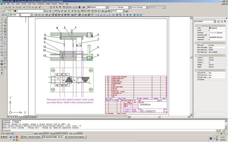

I quoted your message and edited the pictures into it so others can see what you are trying to do ..
It looks like you are trying to use the ARRAY command (or -array). Are you trying to create a couple of 2D views for some kind of metal-working process - CNC machining or CNC cutting?

Regarding 2nd and 3rd (both): The picture ''Addition to drawing 2'' (which is actually drawing 2) is showed what I, unfortunately, have. I would like to get (but with bigger spaces between - how big shows Drawing 1) the following design (please note, I edited it in Paint windows xp program so shown results aren't the best) - of course its obvious that the whole width needs to be bigger:

On your drawing 2, are you sure the element 10 fit the hole below? and are both element 3 and 10 in the position shown in drawing 1?
and I suspect the drawing 1 don't match with drawing 2 as I can't see those '6 hole' fit with drawing 2... sorry as I don't have the files

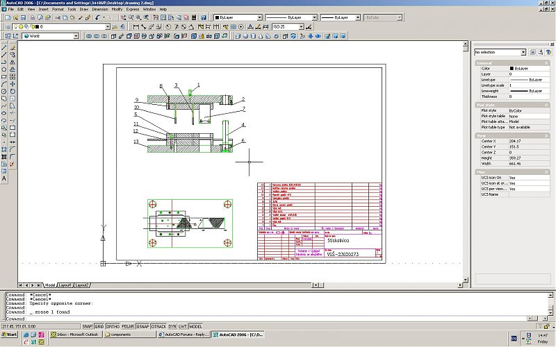

In your previouns post, you mentoined how could i copy and paste Element 1 to get it on the exact area as shown ''Place for Element 1''. Thank you for this. I did all what you said but I still don't get the correct result. It was still even bigger than the whole drawing.
Mate,
First Copy the element1 from Drawing1.
Go to your Drawing 2, right click and choose 'Paste as block'
Left click on where u want. I know they are Big.
Click your element1 block (I will call it block later) and choose 'Move'
Use Top left hand corner as your moveing reference point and put it to the Bottom Left hand corner of the things with 'element 13'.
Use 'scale' and pick the block
Hit space bar (ie to tell Autocad you finished your selection)
Click the Top Left hand corner of the block
Hit 'R' (ie you are going to use reference scale)
Click Top left hand corner of the block
Click Top right hand corner of the block
Click Bottom right hand corner of the thing with 'element 13'
After the above steps, the block should have the same size.....ok?

Issue number 1 is fixed. Element 1 is in the correct size on the correct drawing. But the second and third issue (described in my first post) are almost unbeatable. I have been doing this for the whole day, lose it totally but I have no idea how to do this :cry:.
New drawing with correctly placed Element 1 is here:

Before we could answer your question, are you sure the one on the top are the same 'item' as the one in the bottom??
I am not able to locate those shaft position.
Please Clarify

I showed the drawing to the boss and he said the upper part is OK. Which means, even if I leave two Element2 (same, my, topic on the forum - previouns page - Drawing 2 - post number 2 - 7th picture) instead of six, as I have kept saying this before, will be fine but only in case if I correct this (in blue color is what is wrong, in yellow color is how it should be, in purple color is easier but much shorter correction just in case if yellow isn't visible / understanable enough. Please also note - line thickness are the same - i useed different ones because it shows solution better):
I was trying to delete the wrong lines and recreate them. This way would be the easiest one. But it doesn't let me delete specific lines only. When I try to, it deletes the whole Element 1.
It looks like its a polyline,
Can you move it out TRIM the line(s) you dont need and then move back into place?
I tried TRIM command it doesn't work. In the first step I wrote ''trim'' in command line, then I clicked all 6 lines (which six lines is showed here: http://img.photobucket.com/albums/v309/Andreii/sixx.jpg) and clicked Enter but nothing was removed.
Since TRIM is for cutting, I probably need to move the four circles somehow else, move function (right mouse click / move) won't work.
